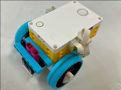

1 PC with Windows 10 or 11 operating system.
SPIKE Prime
  1. Motors:
  2. Left Motor: Port C
  3. Right Motor: Port D
  4. Color Sensor: Port A

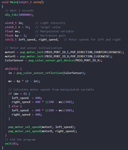

Step 1: What Is P Control?
P control (Proportional control) adjusts the robot’s steering based on how far it is from the line. The further off it is, the more the robot corrects its direction.
The formula is simple:
correction = Kp × error
  1. Kp is the proportional gain (tuning parameter)
  2. error is the difference between the sensor reading and the target value (e.g., line center)
By adjusting Kp, you can make the robot steer more gently or more aggressively.

Step 3: Program
Step 4: Video
In the video, we test three different values for Kp:
  1. Well-tuned → smooth behavior
  2. Too low → weak corrections
  3. Too high → unstable oscillation
