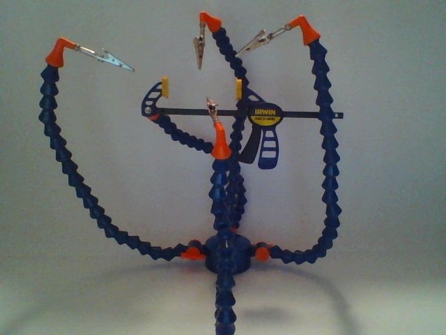

Introduction: Third Hand++: a Multi-use Helping Hand for Electronics and Other Delicate Work.

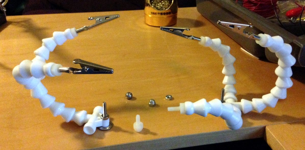

In the past I've used the third hands/helping hands available at chain electronics shops and have been frustrated with their usability. I could never get the clips exactly where I wanted them or it took more time than it really should to get setup right. I also wanted the ability to hold small circuit boards and alligator clips just don't do a very good job.
I was familiar with the adjustable coolant hose systems used to spray coolant at cutting tools in the machining industry and thought that would be a great place to start. I ordered various nozzles and hose segments from my favorite online machine tool supply company and started experimenting. This is what I came up with. While it still has plenty of room for improvement it has served me well over the last 3-4 years.
These arms can be placed into pretty much any position and they will stay there.
Another nice feature is that you can make all sorts of attachments for holding whatever you need to work on. So far I've made a circuit board holder, a clamp, a mount for an LCD, and an extraction fan for keeping fumes out of your face.
All you really need are some simple hand tools, a couple taps, a drill bit and a drill to make the basic version. If you have all the tools you need, it can be made for $20 or less.

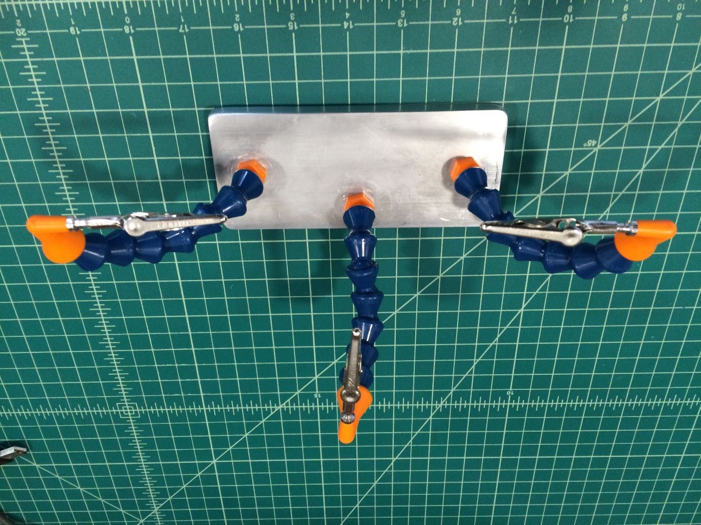

- The Base:
I used a block of 1/2" thick aluminum (5.75"x2.5"x0.5"). Aluminum is heavy enough to be stable and is easily tapped. You can use whatever you want as long as it is at least a 1/2" thick and can be tapped. (Plastic, wood, MDF, steel, etc...) The lighter the material, the larger the base needs to be in order to remain stable. If the material is too soft the threads will wear out and the arms won't stay in. If you don't have a local source for the aluminum you can order it from an online metal sales company cut to length for about $6 plus shipping. I have used www.onlinemetals.com for other projects in the past.
- The arms:
The arms are made from coolant hoses and nozzles used in the machining industry to keep cutting tools cool and lubricated. I used the Snap Flow brand coolant hose system which I bought from www.use-enco.com. They sell a "Male NPT Hose Kit" that has 13" of hose and an assortment of nozzles and connectors. That gets you most of what you need to make a two handed Third Hand. I'd recommend buying two kits and a few extra nozzles and connectors. For around $12 you will have more than enough parts to make 4 arms.
For each arm you will need:
- One 1/8 NPT connector
- 4-5" of hose
- One 1/8" 90 degree nozzle.
You may want to consider buying the hose assembly pliers for $23. They are a little difficult to snap together by hand. I didn't buy the pliers but I kind of wish I had.
- The Hands:
Each hand is made out of a banana plug threaded into the 90 degree nozzle and an alligator clip. I chose the "Flexible Banana plugs (2-Pack)" from radio shack because it has 6-32 threads that will thread into the nozzle. The alligator clips are the standard 2" size.
Step 2: Building the Base - Layout
Once you have chosen your base material you will need to cut it to size, if it has not been done already. I used a block of 1/2" thick aluminum (5.75"x2.5"x0.5").
Next you need to layout the location of the hole for each arm. In this case I'm using three arms. The arm locations are not critical, they just need to be close enough that the hands will be able to reach each other and symmetrical so they look nice. It will also depend on the shape and size of your base material. A triangular base might also be a good way to go if you plan on using 3 arms.

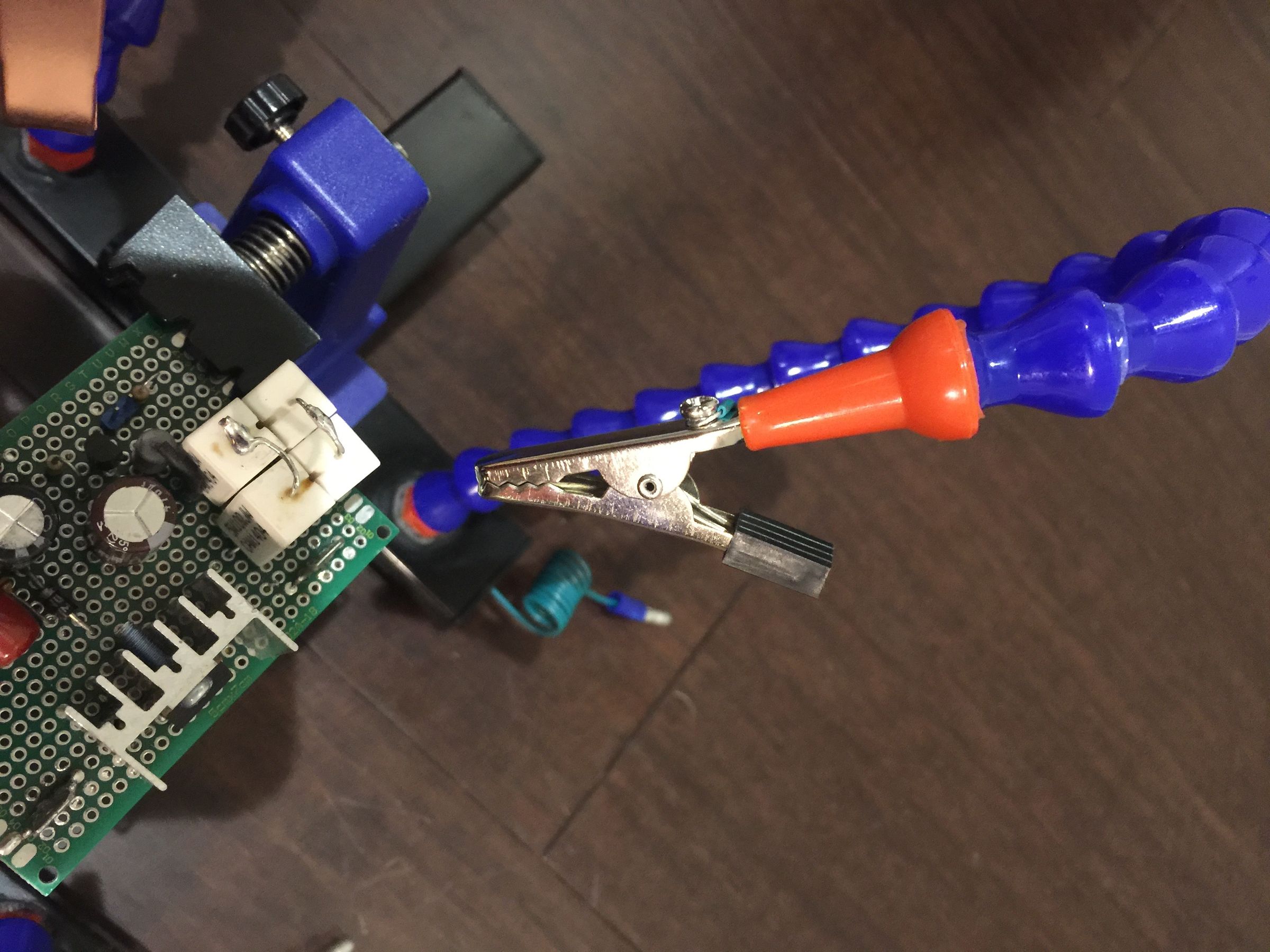

Step 6: Building the Hands
Remove the red and black covers from the banana plugs and discard. We only need the metal parts. Using the 6-32 tap start threading the 90 degree nozzle. The banana plug threads aren't actually 6-32 but are close enough and provide a nice tight fit. Once the banana plugs are installed you can just slide the alligator clips onto the banana plugs.
The alligator clips work pretty well as is, but they do have a tendency to rotate when holding longer or heavier items. In the next step I'll show you how to improve them.
Step 7: Improving the Hands - Optional
As I said in the previous step, the hands have a tendency to rotate on the banana plugs. While this is a feature I wanted, the ease at which they rotated was a problem in some situations. This is in part due to the alligator clips expanding when installed. You can see the gap in the picture below. To fix this I came up with a couple solutions. You can certainly skip this step and be happy with the results but doing this will make it a lot easier to use.

Wrapping with wire.
I found some thin solid core wire, wrapped it around the clip and soldered it in place. This is the easiest and cheapest solution to the problem.
Step 8: Assembling the Arms
Unless you bought the assembly pliers($23) when you ordered the coolant hose parts, assembling the arms can be a little tricky. I didn't buy it, but here is how I figured out how to put them together with ease. Slide the parts you want to join onto a #2 Phillips screwdriver. This will keep everything aligned and all it takes is a sharp tap to get the parts to snap together. Just hold onto the hose and tap it on the work surface in the direction of the part you want to attach.
Although theses pictures show 10, I found that about 7 hose segments per arm to be about the right length. Of course that is my preference and you can use as many as you want.

Now all you need to do is thread the arm assemblies into the base and you're done!

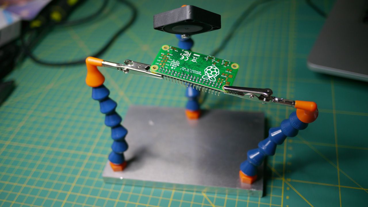

Step 10: Attachments - Circuit Board Holder
The circuit board holder has been one of the best attachments I've made for the third hand. I've used it to hold boards as small as an inch wide all the way up to ~8 inches wide.
Making these might be beyond the capabilities of most people because of the tools needed.
I used two pieces of 1/2 x 1/4" aluminum** each about 2.5" long. In the end of each I drilled a 5/32" hole around 3/4" deep. You could do that with a hand drill and a vice but there isn't a lot of room for error. A drill press or a mill would be best.
To make the slot I used a slitting saw in my mill. The slot is a little over 1/16" wide and 1/8" deep running the entire length of the rail. I suppose you could do this with a hack saw or dremel, but it would be difficult and I suspect the results would be pretty rough.
** - Next time I would make them out of Delrin or other plastic since many circuit boards have components and traces right up to the edge of the board and could be shorted by the aluminum.
Update - Below is a picture of the circuit board holder made out of black Delrin plastic. These were a bit easier to make since I was able to use a 1/16" end mill instead of the slitting saw.

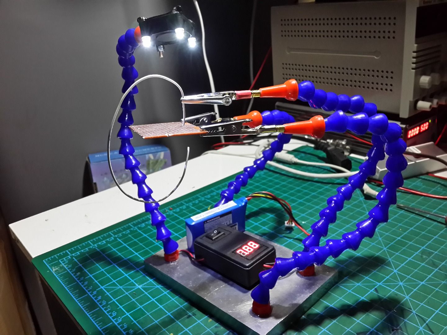

Step 11: Attachments - Fume Extraction Fan
I made an extraction fan using an old CPU cooling fan, a bit of filter material, another 1/8" 90 degree nozzle and a couple screws. All stuff I had lying around the house.
For the filter I cut a piece of white scotch bright to the shape of the fan and attached one corner with a screw. The opposite corner I used a long screw to go through the fan and filter into the nozzle. Connect it to a twelve volt source and solder without having fumes in your face.
In my next version I plan to add white LEDs to provide extra light in addition to the extraction functionality.

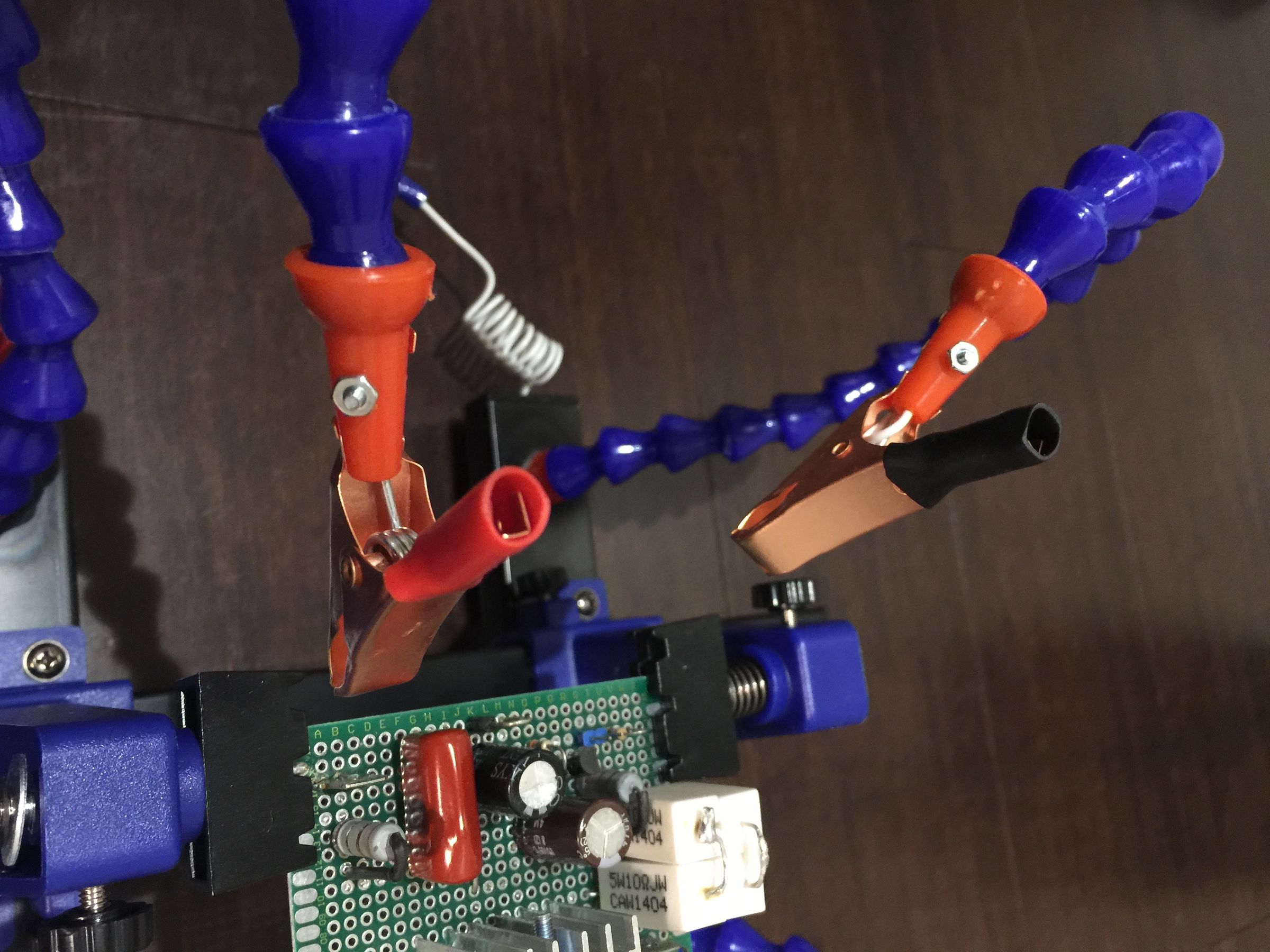

When I made the first version, which I've used for years, I was concerned with ESD and so I soldered a wire to the banana plug which ran inside the arm and was grounded to the base. I also drilled holes in the front and back so I could plug in a static wrist strap in the front and in the back, connect it to the static ground at the workbench. I probably should have soldered in a 1M ohm resistor to the wire going to each hand for more protection.
Powered Hands
I've also thought about adding binding posts to the base and wires going up to the banana plugs so that voltage can be applied to the hands for powering circuits or loads being held by the alligator clips.
The down side to the above ideas is that the left and right hands are wired to the base so changing attachments, that requires a nozzle change, means you have to disconnect the wire. However, most of the attachments I made that require a nozzle change are primarily used on the center arm. The alligator clip hands and the circuit board holder just slide onto the banana plugs so no nozzle change is required.

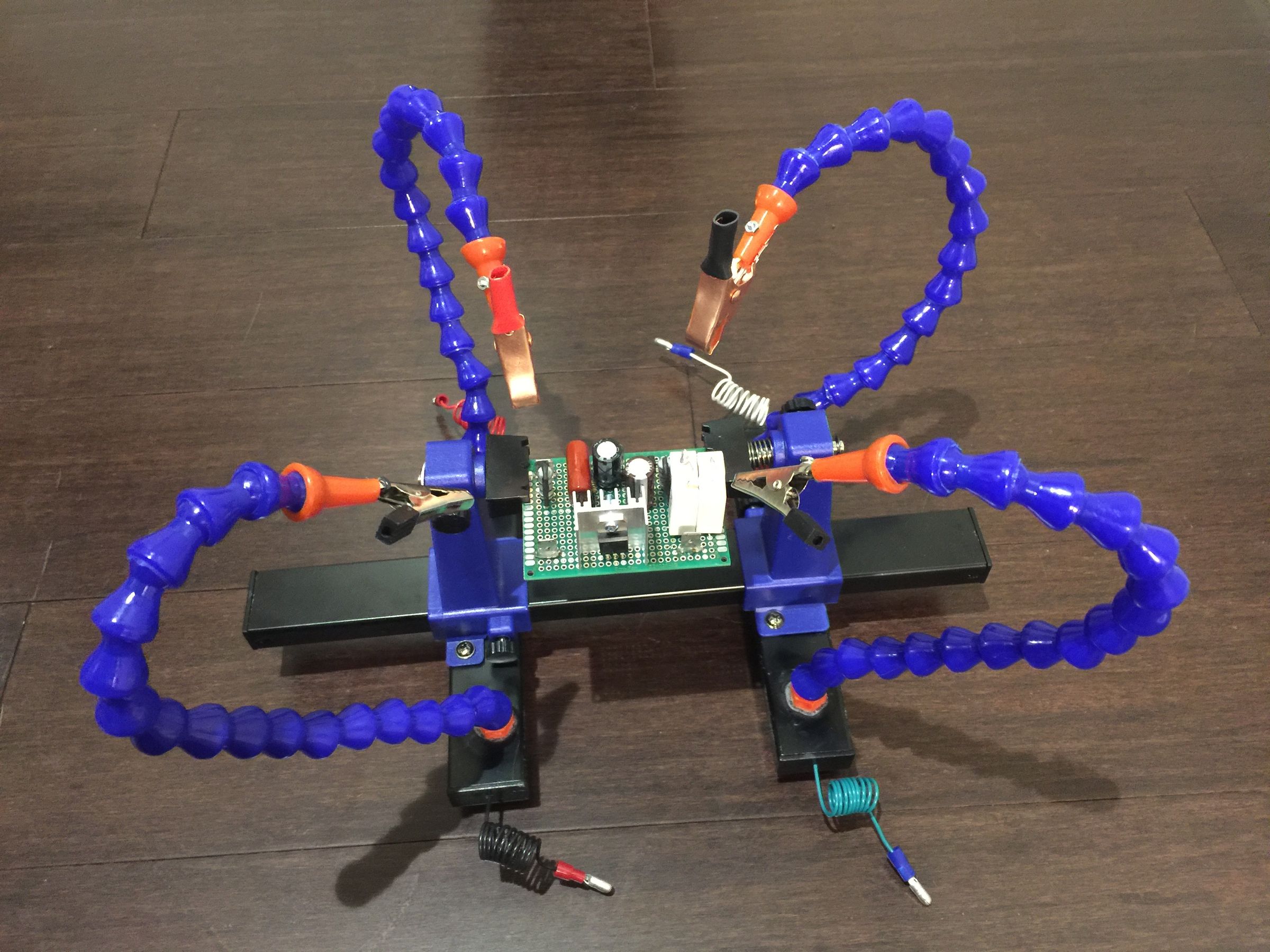

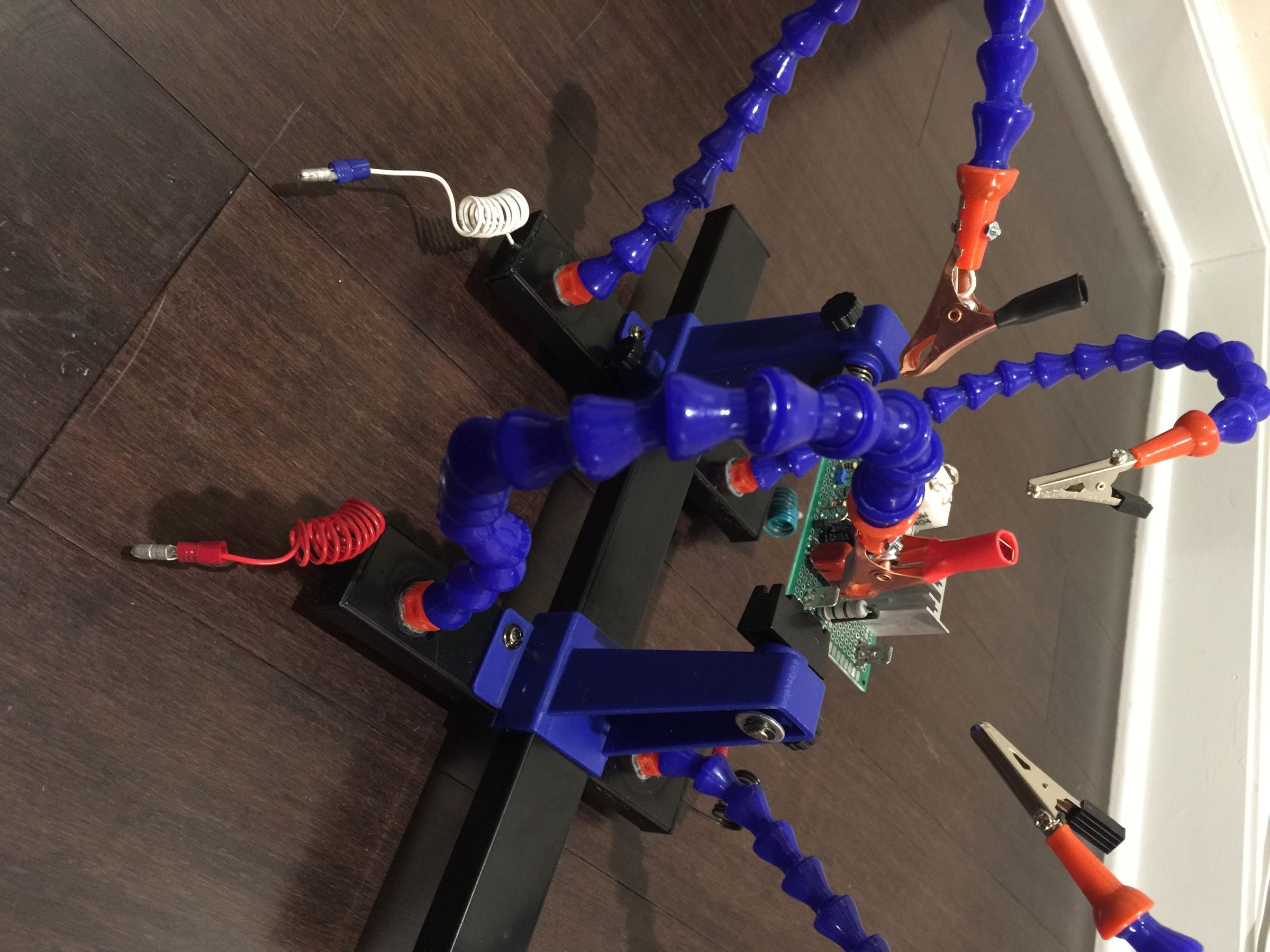

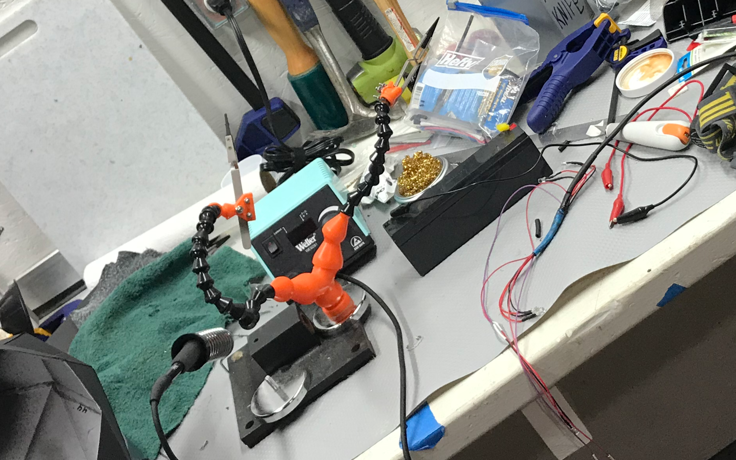

Another variation of this by using the premise circuit board holder plus the flexi pipes and alligator clips some hookup wire you can really upgrade it nicely.
0
treesap
treesap
Reply 4 years ago
I love the idea of attaching these to the PCB mount. I'm going to use the extra arms that came with my set to do this. Thanks for the idea!

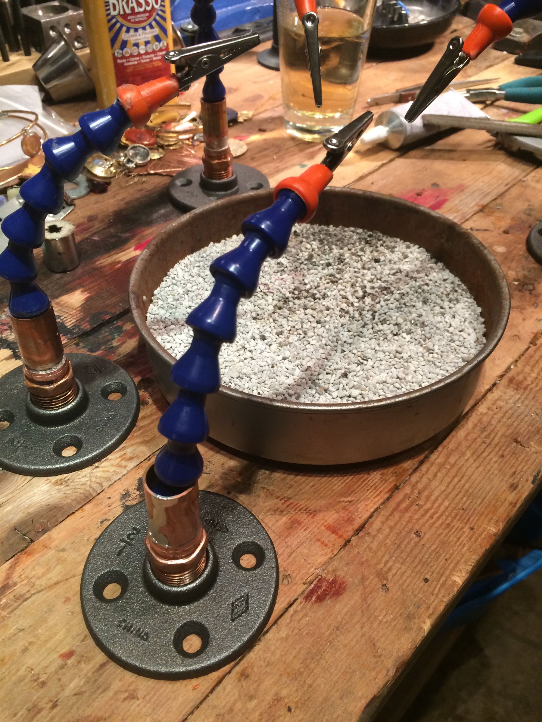

You have to add a piece of 1/2" copper pipe to the 1/2" male adapter. It just slides inside the adapter. You could glue it in but it would be better to solder it
0
ClydeS
ClydeS
7 years ago on Step 1
Perfect! I was soooooo tired of using crappy third hands for soldering. This is just perfect.

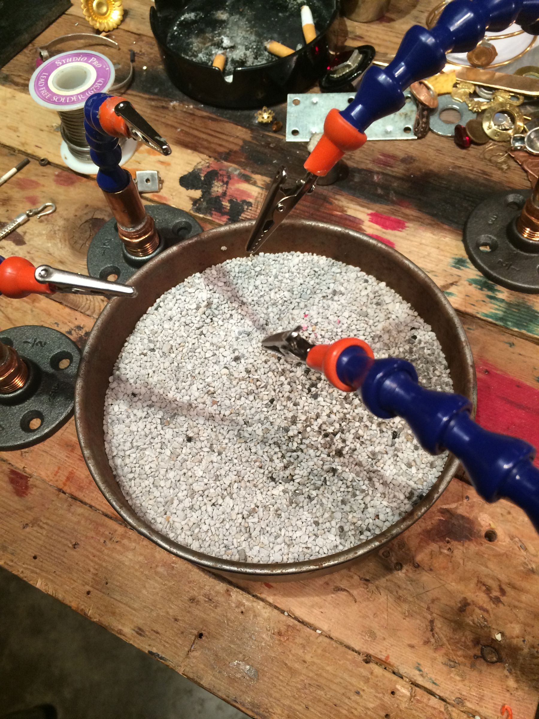

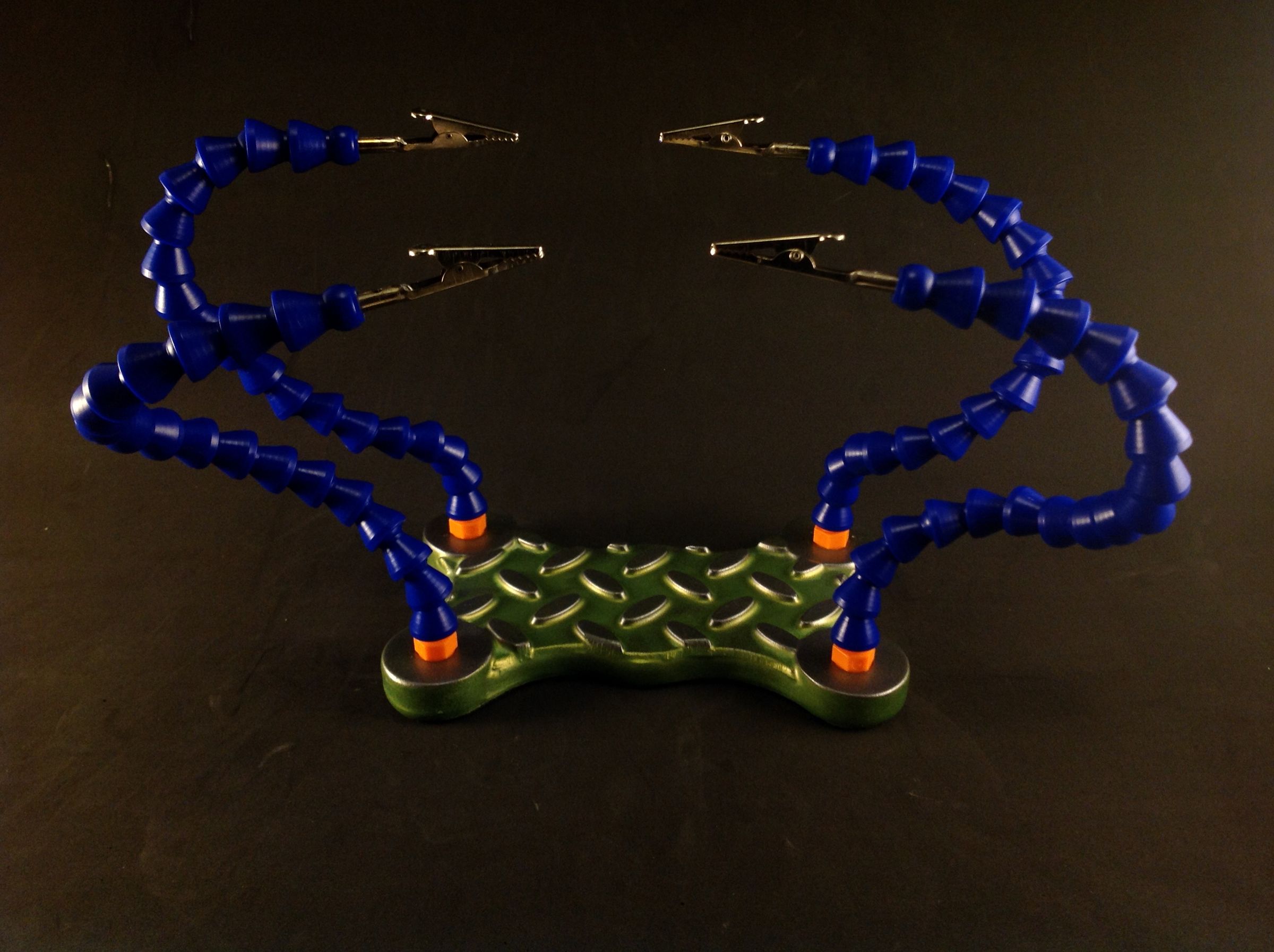

I modified mine so that each arm is on a freestanding base instead of a fixed station. This provides much greater flexibility for the sort of soldering that I do -- jewelry mainly.
The base is made of a 1/2" cast iron floor plate, a 1/2" male adapter (copper plumbing fitting) and a 1/2" connector. I removed the "valve" piece on one end of the tube and inserted that into the connector/base along with some glue. Then inserted and glued alligator clips to the other end. I also filed down the teeth on the alligator clips so as to not mar the soft metals that I work with.
I made four of these with two being half the size of the other two, again for greater flexibility.

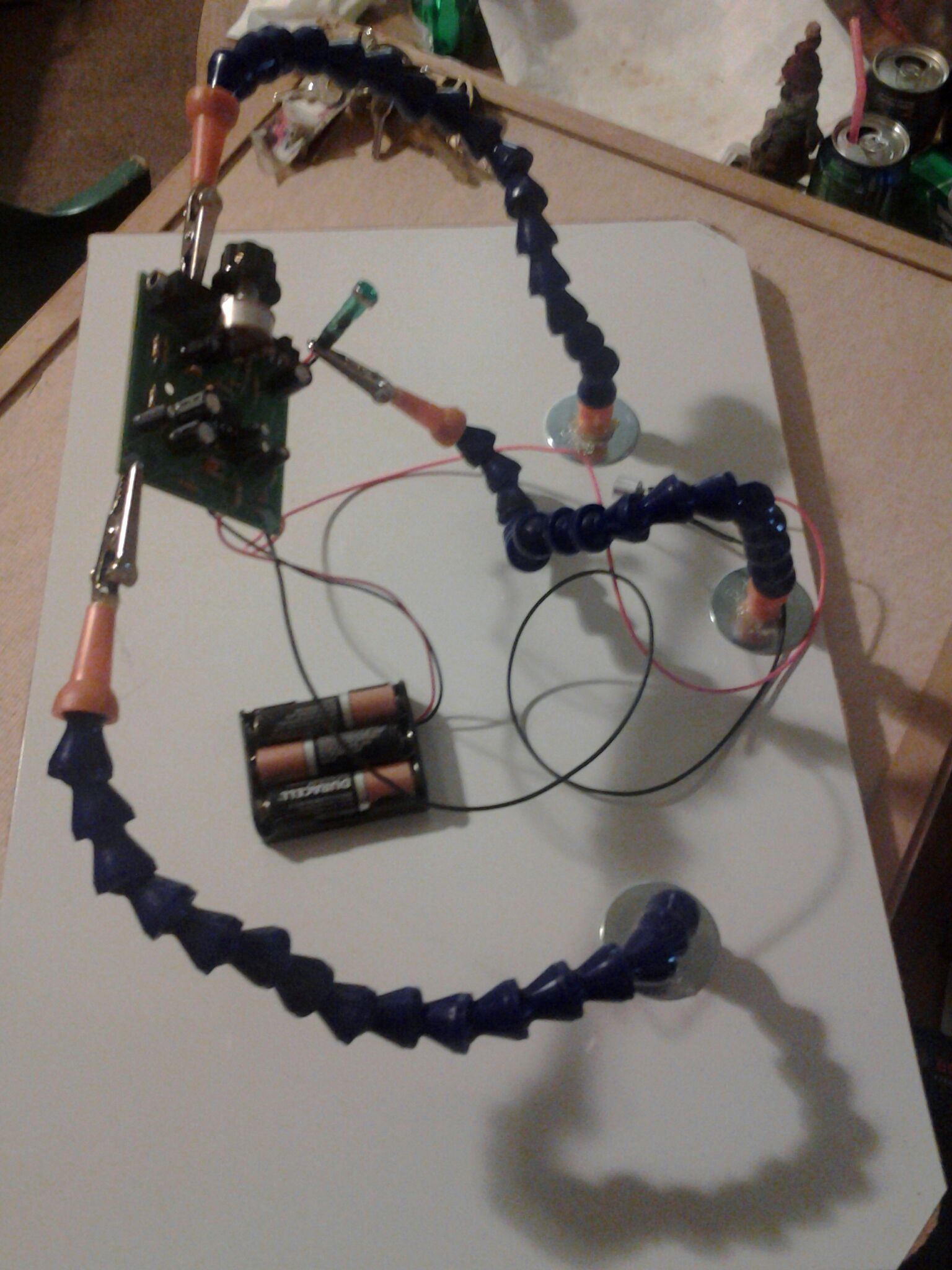

I'm building the same thing, with the magnet fittings from locline instead of tapping my steel block.
However, since I'm using a 14x14"x1/4" steel panel as a workspace as well, I'd like to coat it so it's not a bare metal surface that is a) conductive b) hard (dropping delicate components) c) slick (said components rolling off, and if unbroken before, broken upon falling off the surface).

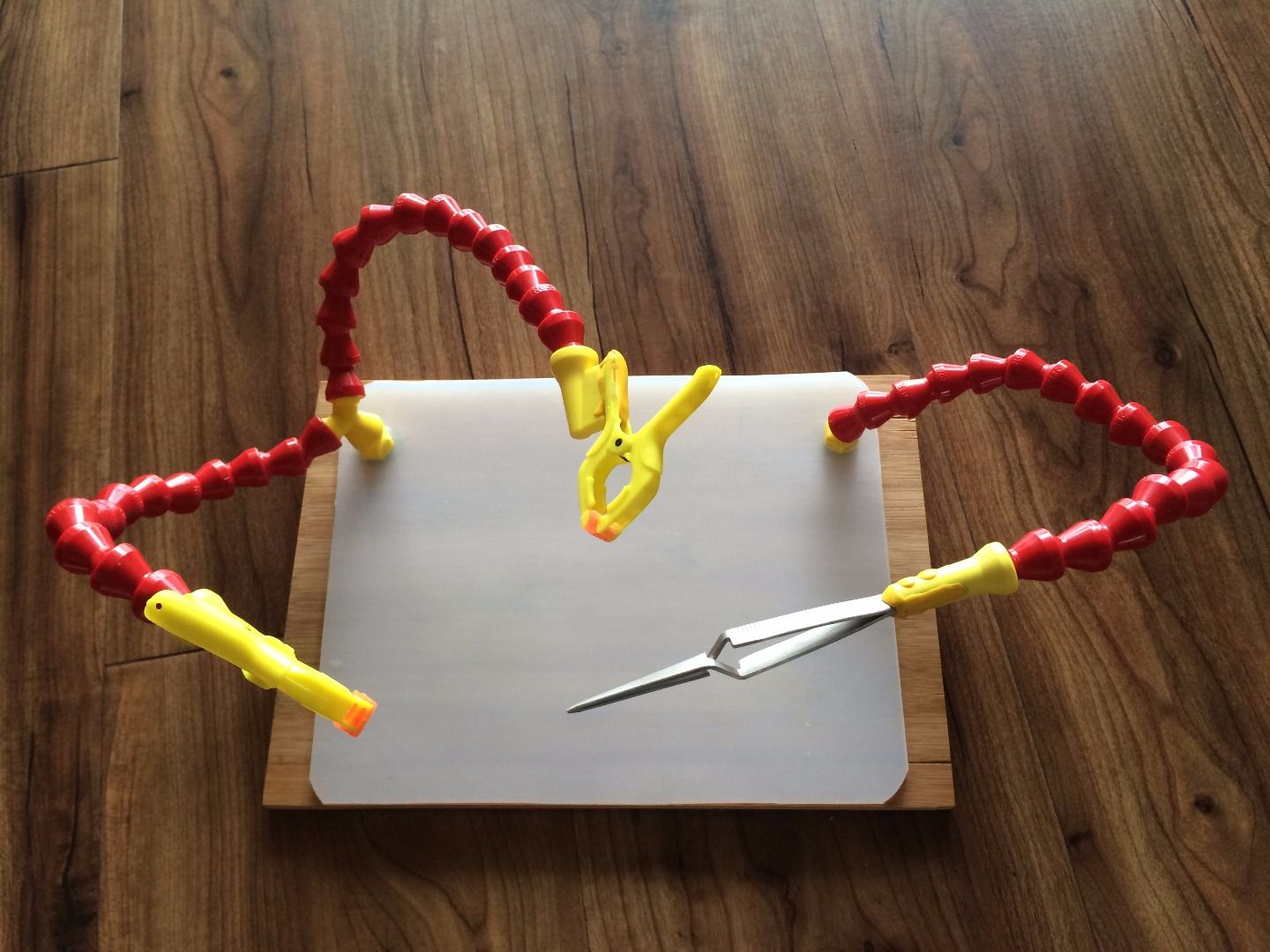

I do a little out of the box thinking Children's mats made from recycled rubber type material sold in Aldi and Lidel stores in the EU and UK of course.
I have them on my Garage workshop floor and on my work bench, nothing has ever broken these mats lock together like a jigsaw. anti slip too not sure about anti satic?

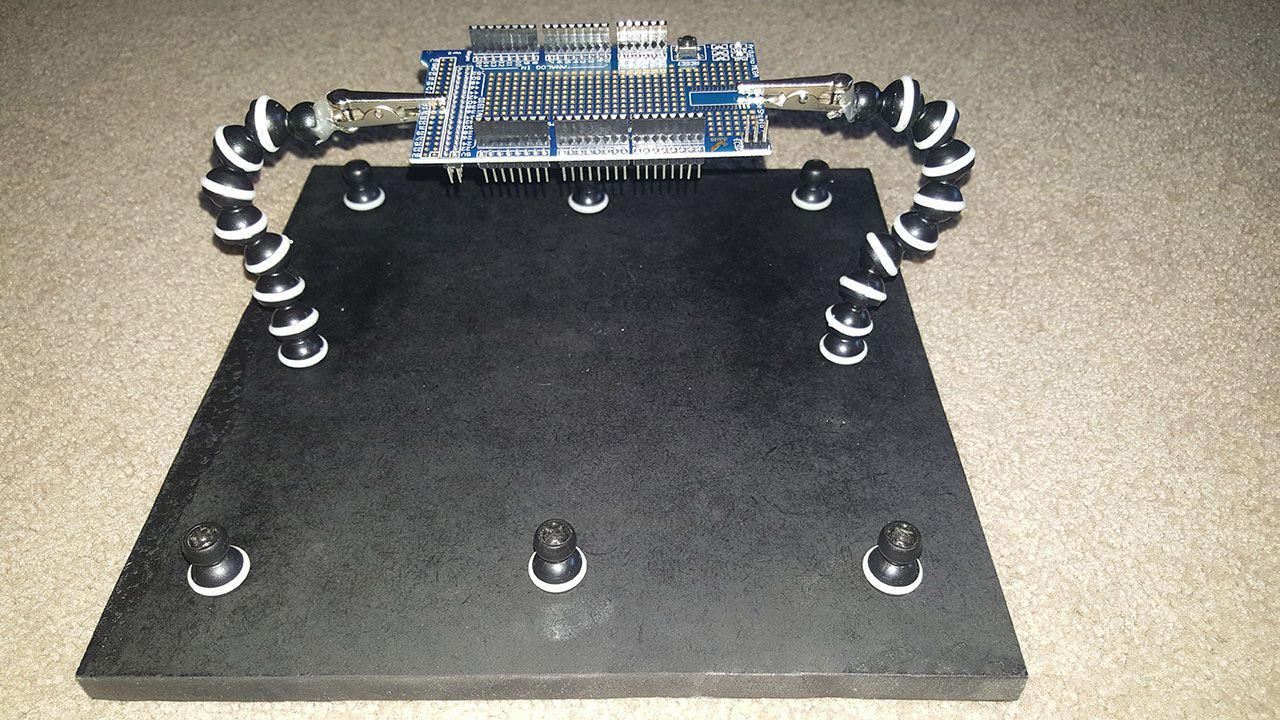

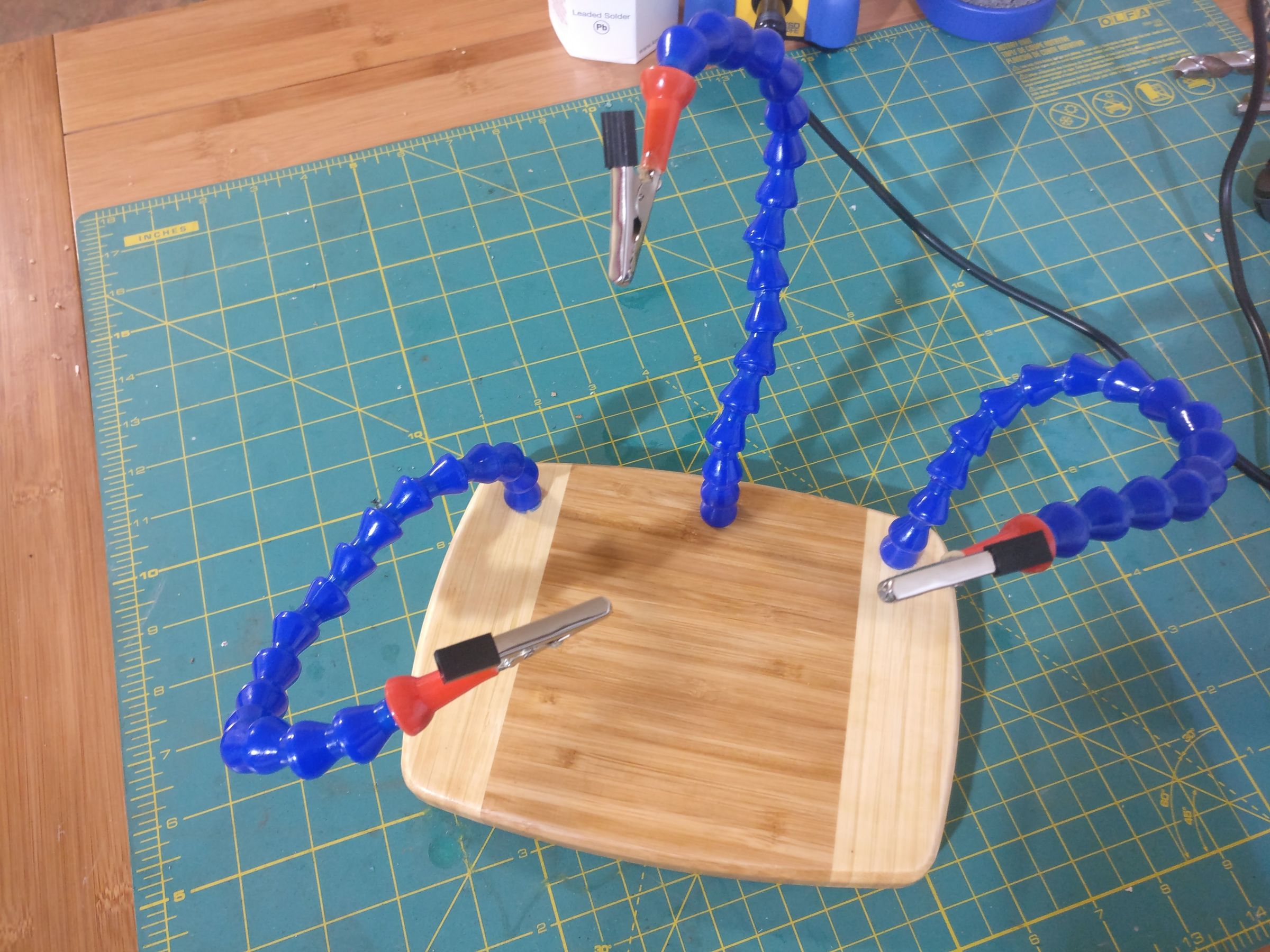

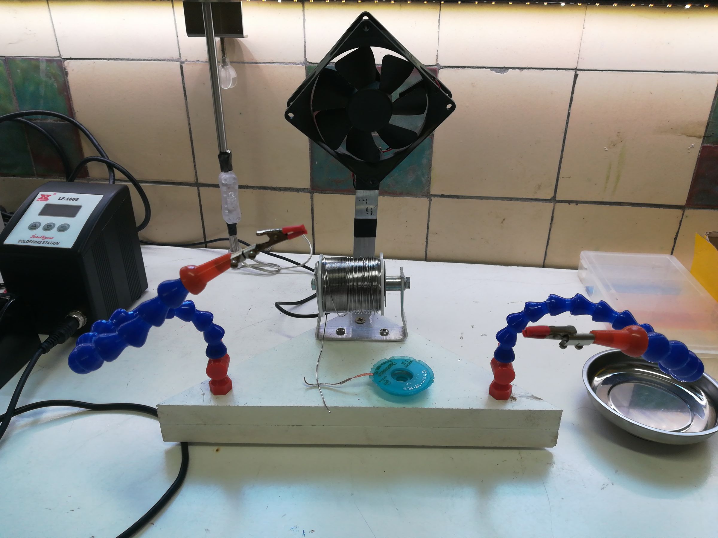

This is a classic. I finally got around to making one. I made my workstation from wood and drilled holes to mount the arms (via 3-way junctions, machine screws, and hex nuts.) This way the arms can spin.
Mounting the attachments to the loc line was an issue because I didn't have nozzles handy. I also wanted more flexibility. So I hotglued 8-32 nylon thumbscrews like the ones here below into the links.
http://www.amazon.com/dp/B000OD0JOA/ref=biss_dp_t_...
Hot glue bonds well to nylon and I hope to the plastic of the loc line. Time will tell, but it seems really solid. I like this solution because I can mount anything that fits onto an 8-32 screw with an acorn nut, hex nut, or even a decorative filial (pictured). Thanks again for the idea!

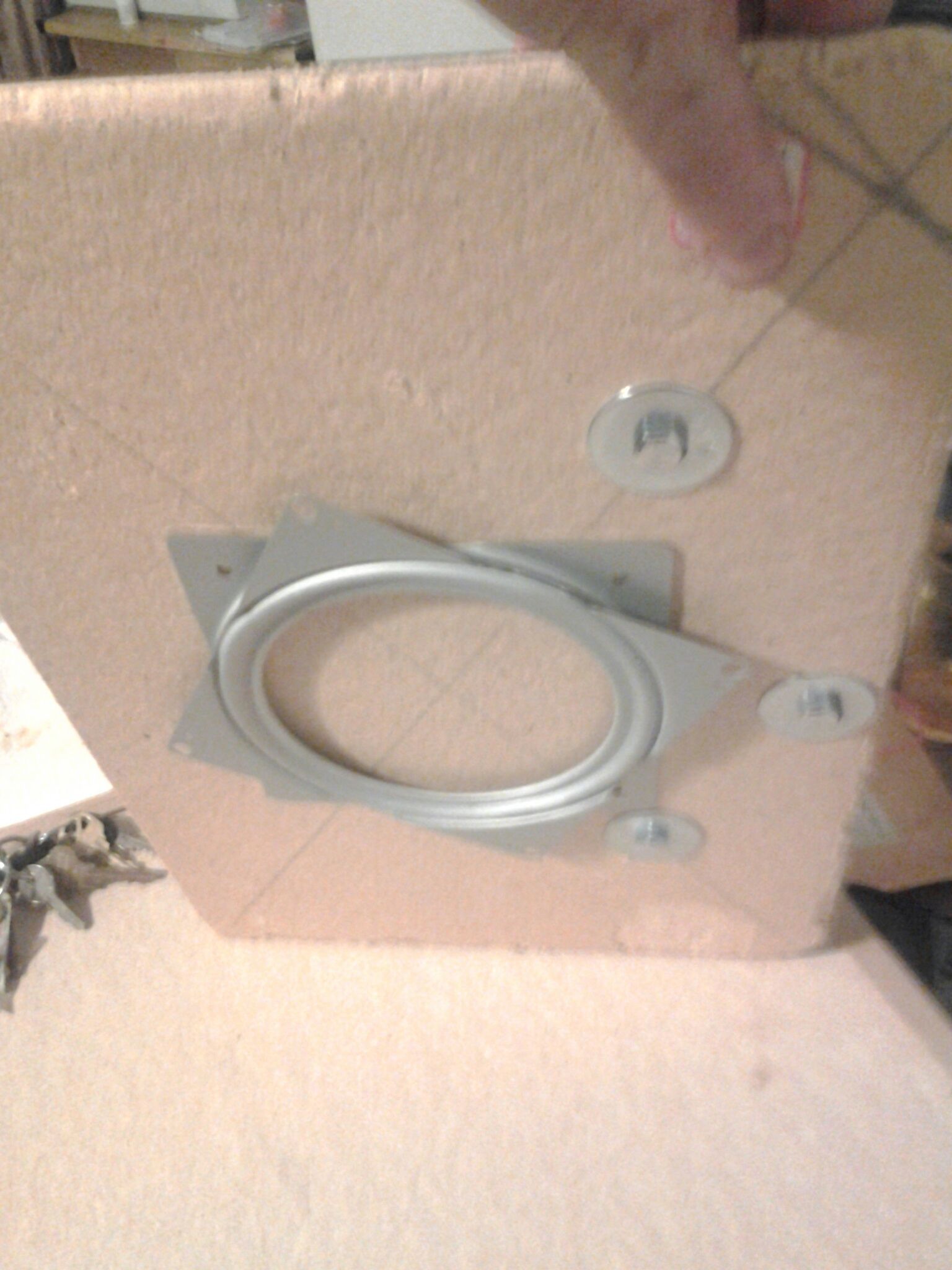

here is my spin on your idea...I mounted it to a lazy susan apparatus
