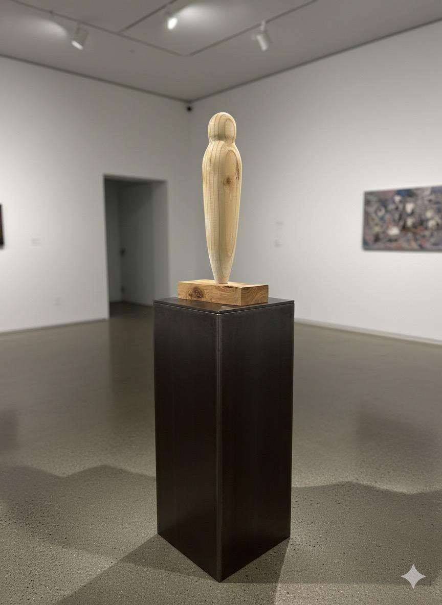

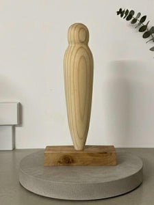

I cut a fence post (the end without any nails), and then fitted the piece onto the wood lathe.
Step 2: Shaping the Body

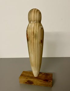

I shaped the main body on the wood lathe. The shape I was going for was in the form of a large bird body (this was meant for another project altogether!). After some time I managed this shape.
Step 3: Making the Base

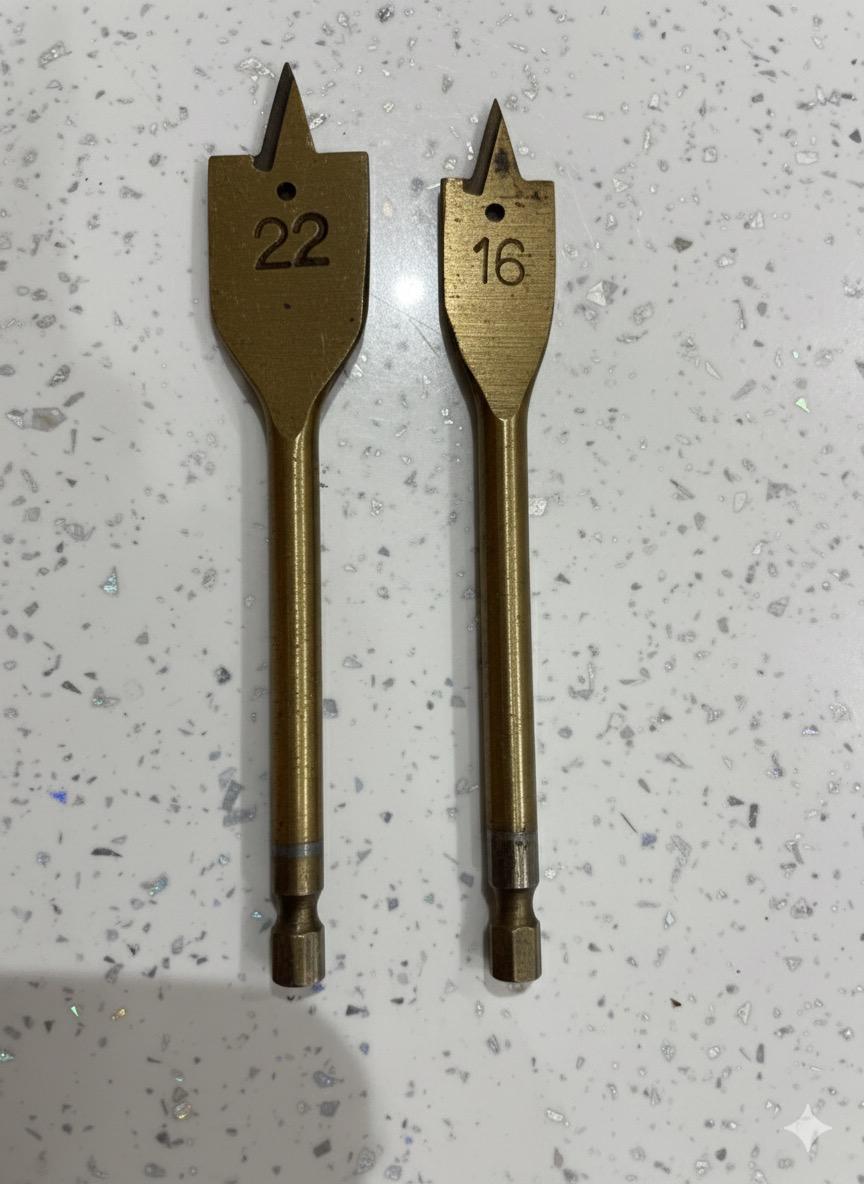

I used a scrap piece of hardwood for the base, choosing a size that would visually and physically balance the main body of the sculpture. After marking the centre point, I drilled halfway through the wood using a 22mm bit. Then, I switched to a 16mm bit to continue the hole all the way through the base. To ensure a snug fit for the main body sloping tail, I carefully shaped the hole with a wood chisel, creating a gentle slope that mirrors the taper of the main body. Finally I fitted the main body onto the base.
Step 4: A Sculpture Appears
My final step was to leave my creation on a outside area – ready for painting. Amazingly folks kept noticing and commenting on my ‘creation’. It was then that I realised that I had unintentionally created a piece of interest. Folks kept asking “Whats‘at – So I named my sculpture the Whats’at, and it now has a prominent place in our local Menshed for all to see and hopefully – admire.
