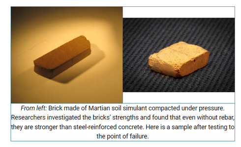

First topic of discussion is the RPS, and why I chose to make it out of mars regolith bricks as opposed to 3D printing them with regolith. The reason comes down to cost and time. With mars regolith bricks, I can save a lot of money and time since the bricks can be FULLY made from In-situ materials: mars regolith. In comparison, 3D printed mars RPSs are only partially In-situ based since they require a minimum of 30% binder by mass, meaning that several tons of binder need to be shipped on location, wasting money and time. Additionally, bricks save a lot of time in money in reduced production and energy costs, since the only tools you need is a rubber mold and a weight to compress the mars regolith to form the brick, as opposed to the large and enormous amount of machinery and energy required to make 3D prints. Finally, these bricks save time in construction because they can be quickly produced and assembled in comparison to 3D prints which can take weeks or months to complete. These bricks have shown to be equal in strength and durability in UC San Diego's and NASA's partnered experiments.
Ultimately, the reason behind my choice on mars bricks is that they save time, money, and more time. They are really the best for this type of application.

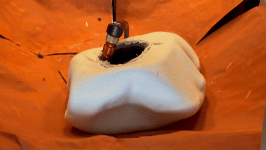

Step 22: Scale Model: Inflatable
Moving on to the inflatable scale model, these are the materials I used to create it. I used a 10in diameter innertube that I recycled from an old wheelbarrow, a 3D printed spacer that I made to sow on the clothe, and old T-shirt clothe (make sure it is stretchy).
Step 23: Assembling
First I cutout the t-shirt fabric into two 10 inch discs with 3 inch holes in the center. Then, I sowed together these two pieces at the outer edge. After sowing, I flipped the new disk piece inside out so that the outer seem was on the outside. I placed this on the inner tube, and started to sow the inner edges of the fabric to the spacer. I made sure to align the slots in the spacer with the innertube valve as seen above. And Done!
Step 24: Final Result
Here is the final result. I used the airlock from the Full-scale model to finish off the look. I also inflated the model using a basic tire pump, you can see the video below:
Step 25: Final Result: Video
Inflating the inflatable scale model with my tire pump.
