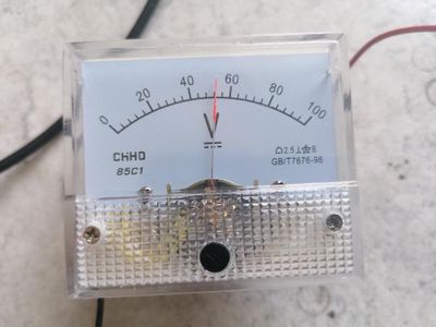

To check the voltage across the capacitor bank I use a 100V panel meter. However, in order for it to be able to display voltages from 0 to 1000V, it needs a corresponding series resistor. The resistance of the panel meter is around 90 kOhm. For a 1:10 ratio, the series resistor must be 9 times as large, i.e. 9*90 = 810 kOhm. Then an applied voltage of e.g. 600 V is displayed with only 60V. The scale can then be supplemented with zeros without any problems.

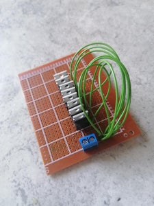

The thyristors serve as high-current switches. A single thyristor can withstand a surge current of 300A. But this is not enough. Therefore I connected 8 of these thyristors in parallel. The peak current can be 2400 A. The gate control of the thyristors is very simple. For this purpose, a single 18650 Lion battery is connected to the gates via a button. So that the gate signals all arrive at the same time, I used cables of the same length for all gate connections.
