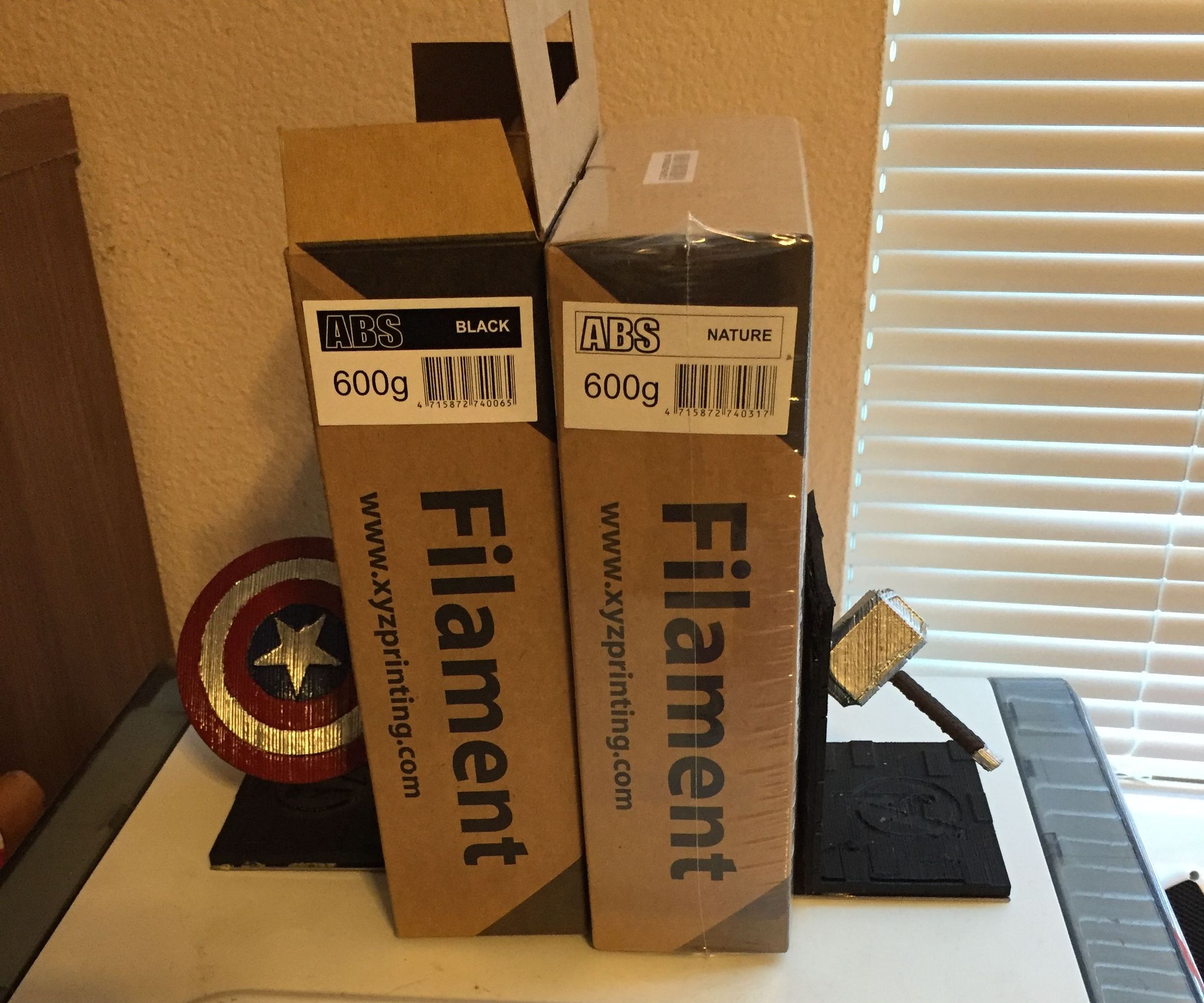

An finally, it is done. I then created and painted gold a hanger and placed Mjolnir up on the wall next to Captain America's shield. [Note: some of you may notice from one or two pictures there is a dent or waved section from a certain angle. That was not part of the construction process. That was my testing to see if the topper was properly attached by giving the hammer a swing, only to discover it was not properly attached. The top flew off, the hammer flew across the yard and . ...well it now has a dent. But you cannot tell from where it its on the wall)
