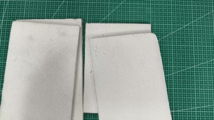

Step 1: Locker Box
  1. First, I glued the four side walls together, front, back, and two sides.
  2. Then I carefully placed and glued the bottom panel ( 25x20 cm) under the box frame.
  3. To keep everything aligned and stable while the glue dried, I inserted toothpicks through the edges where two sheets met. This worked like temporary dowels.
  4. Once the glue was dry and solid, I clipped off the extra parts of the toothpicks sticking out.
  5. Reinforced the inner joints with a bit more hot glue for added strength.
I built the enclosure using thermocol sheets. it’s lightweight, easy to work with, and good for testing. But if you're planning to use this in a real application. I highly recommend a metal or wooden enclosure for better durability and tamper resistance. If using metal or wood, consider using small screws.

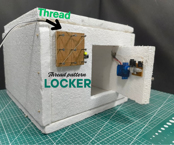

Step 9: Result
The locker works just like I imagined — it only opens when the correct thread pattern is drawn across the nails. If the pattern is wrong, the bolt stays locked. The motor drives the bolt in and out, the limit switches handle end stops, and power can be connected from any USB source. It's a mix of electronics, mechanics, and a little bit of puzzle-solving — all packed into a DIY build.
