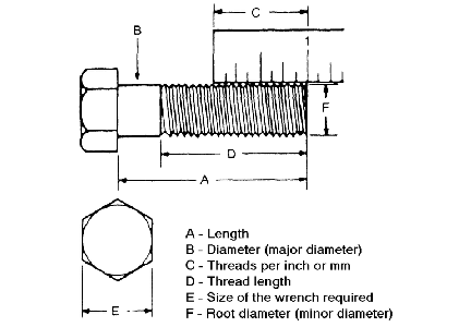

The size of your bolt and threads will be determined by the lengths you give to A and B in the second image. Distance A will become the major diameter of your bolt. Distance B will be the minor Diameter. These are B and F respectively in the example image I've included 3rd.

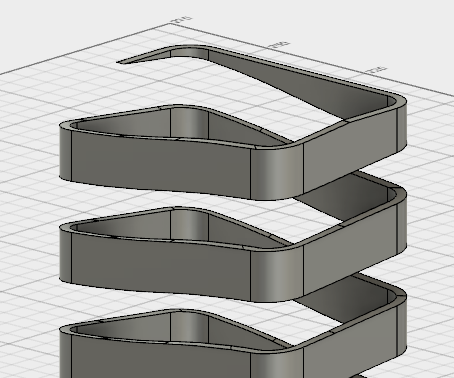

Next you're going to move the shape into place. Start by moving it up the Z axis. (Image 2) The distance that you raise the shape should be 1/9th of your pitch. I went with 1mm so my pitch will end up being 9mm, not terribly practical but it gives you the idea. The reason you raise 1/9th is that there will be 9 steps in this half revolution of your threads.
Rotate the shape you've raised 20 degrees. (Image 3)
Repeat these steps 8 more times. Each time copy/pasting the highest shape, raising it up, and rotating it. Be sure to raise and rotate the same amount each step or your threads will come out wonky.

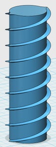

Step 3: Loft
Select all the shapes you've created. Be sure to select them in order from bottom to top. (Image 1)
Now, loft them. (Image 2)

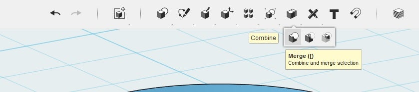

From here you can copy/paste the solid bolt section you have created and raise it up the Z axis to match up with the existing section. (Image 1) Repeat this step as necessary to give you the thread length required for your project. When you're done you can make all your sections into one object by selecting the Merge option. (Image 2)
