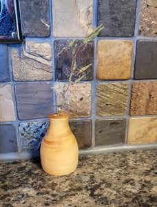

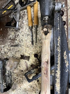

Step 1: Making a Dry Vase
1.Take your blank and use a roughing gouge to rough it down. I forgot to take pictures but it's pretty simple. However, if you need instructions YouTube has you covered.
2.Next, turn down the neck of the vase using a skew chisel. Use a caliper to get your desired size.
3.Smooth out the curve with the same chisel. Now is also the time to add any details such as grooves or rings.

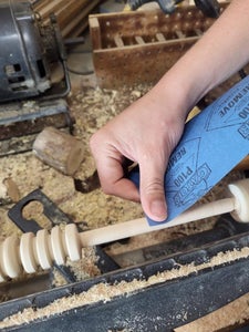

4.Sand well, starting with low grit and moving up. If you are sanding with the piece on the lathe, stop before using another grit and sand with the grain to get rid of any scratches.
5.Drill a hole in the top of the vase and sand it as well as possible.
6.Use oil or stain to seal the outside of the vase.

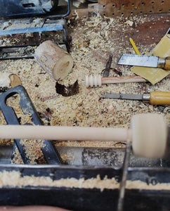

Step 2: Making Handles
  1. Rough down your blank again using the roughing gouge.
  2. Round off the ball of the handle with the skewing chisel.
  3. Sand the handle starting with a low grit and moving up.
  4. Use the parting tool to cut most of the way through the piece; then use a saw to finish cutting through.
  5. Sand the ends smooth.
  6. Drill a hole in the smaller end of the handle. Use epoxy to glue a section of threaded rod into the hole and find a nut to fit it.
  7. Attach it to your cabinet, door, etc. This is a very simple handle. Yours could have rings or anything else really.

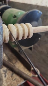

Step 3: Making a Honey
  1. Rough down your blank.
  2. Get the larger end of the honey dipper down to the size you want it. Mine was about 3/4in across.
  3. Using the parting tool, carve grooves in the end of the honey dipper. This is how the honey will stay on the dipper.
  4. Thin down the handle with a flat chisel.
  5. Sand it very well. This is very important because you don't want pores for honey to get stuck in.
  6. Take it off the lathe and cut off the unnecessary wood from the ends.
  7. Use food safe oil or stain to seal it. I used vegetable oil, but the wood seemed to get stringy after a while.
