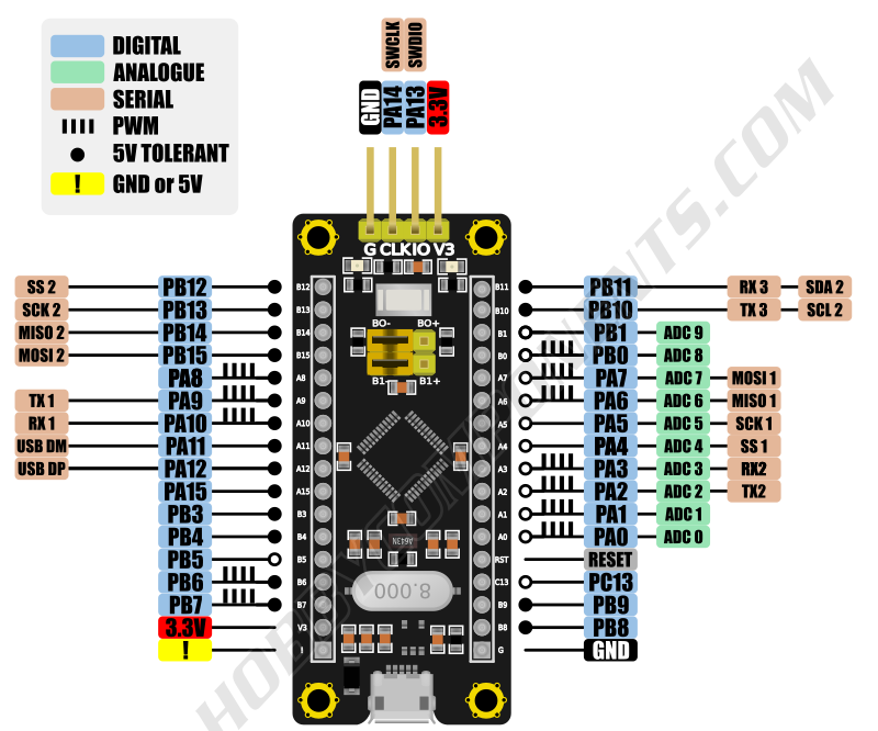

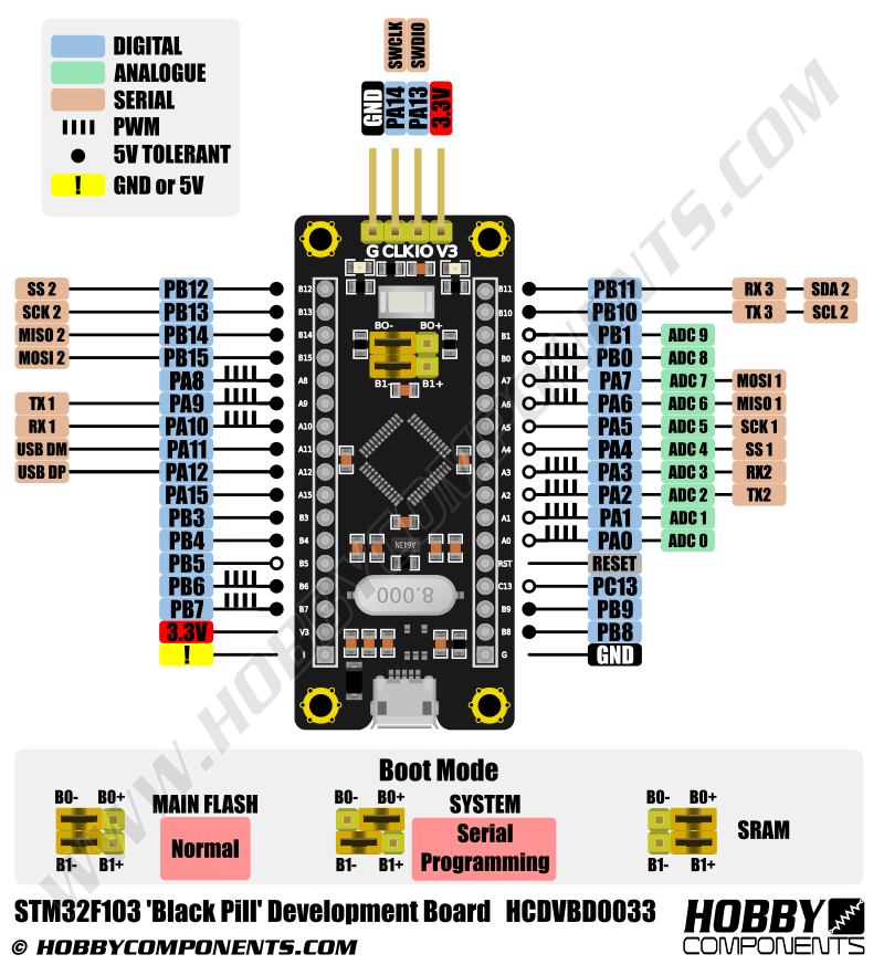

Step 3: Pin Configuration
Once that’s done, it will open up the pinout and configuration page. There it’ll display the physical shape of the MCU, and the pins and pin names. This is where you can set individual pins to different default values, and the IDE will use this info to auto-generate setup code. In our case, we want to just left-click the PA5, PA6, PA7 pins, and click “GPIO_Output”. These pins are the pins connected to the LED's
