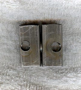

Step 2: Cut and Drill the 3/4" Tubing
First cut two, 1" lengths of 3/4" tubing. Then drill 1/4" holes through the center of the two opposite sides for the threaded rod connector.
Place a fender washer between each piece and insert a 1/4" approximate 1/2" threaded rod. On each end of the threaded rod inside the pieces of 3/4" square tuning add a fender washer, cut washer and nut.
Make whatever adjustments are necessary to the length of the threaded rod to allow the washers and nuts to be installed so that there is at least 1/4" space between the ends of the threaded rod and opposite inside wall of each piece of square tubing. (See picture.)

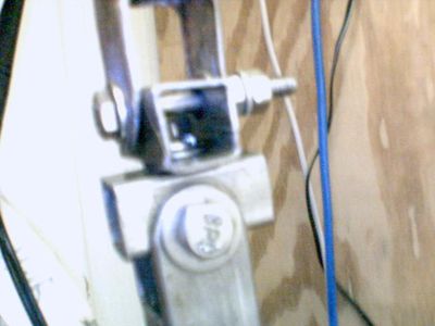

Step 3: Drill More Holes
The next set of holes is on the sides perpendicular to the holes for the threaded rod. These holes are off centered so that the bolt will fit between the inside wall of the tubing and the threaded rod and nut and act as both a stop and as a joint. (See picture.)

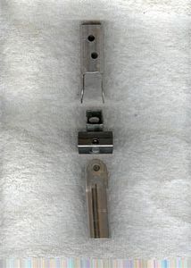

Step 4: Cut and Drill the 1" Pieces
Now cut two pieces of 1" tubing to whatever length you want and drill 1/4" holes through opposite sides about 1/2" from the ends.
On the sides that are perpendicular to the holes cut along the edge and remove a strip of metal about 1-1/4" long. (See picture.)
Now drill your mounting holes or whatever.

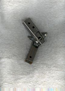

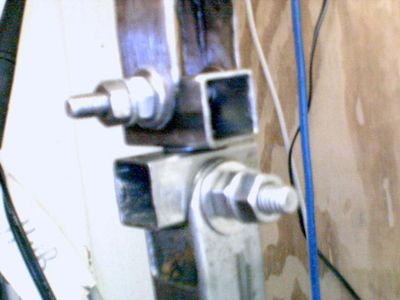

Step 5: Add the Hex Head Bolts
Now insert the bolts into a fender washer, then through one of the holes on the 1" tubing, then through another fender washer then through the holes in the 3/4" tubing then through a fender washer then through the other 1" tubing hole and then through another fender washer. (This may take lots of patients and some manual dexterity.)
Now mount a nut on the end of the bolt and screw it down to the bottom of the threads, add a cut washer and screw down the other nut.
Now repeat this prodecure using the other 1" piece.
Vah Wah Lah! Your three axis connector is now assembled.
Enjoy!
...also please report any possible uses.
