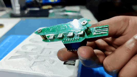

This is THUMB DRIVE, a portable RGB backlight that can be plugged into any USB port directly.
The whole Light board is made from two PCBs connected together using PCB standoffs.
The XIAO ESP32 C3 Dev board drives the WS2812 LEDs, which are positioned on the main board.
On top of the RGB LEDs, we have placed another board that is modeled after the cursed fingers of Sukuna from Jujutsu Kaizen. We modeled the finger after the character for aesthetic purposes.
Since we integrated USB pads directly onto the PCB, this board does not require an extra USB socket. The board can be directly plugged into a USB port and will function.

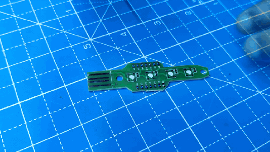

Step 1: DESIGN
Initially, we prepare the PCB design for this project by creating a schematic with four WS2812 LEDs connected in sequence as well as four 100nF capacitors connected to the VCC and GND of the LEDs.
We added a XIAO ESP32 C3 DEV Board to control these LEDs.
Additionally, there's a CON4 port, which is actually the pad modeled after the USB port.
We initially uploaded the picture of the SUKUNA finger that we came across online after converting the schematic into board files in the PCB Editor. We uploaded the picture in BMP format to PCB Cad and then duplicated it to be put next to the original.
We edited the first image, which will become the main board that will house all the electronics, and the second image will be the SUKUNA finger board.

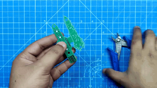

Here's something interesting: we placed two PCBs side by side and joined them together using a 10mm-wide rectangle, which will allow the manufacturer to make this board as a single PCB.
The idea here was to manually cut conjoined PCBs using a cutter.
After dividing the single PCB into two pieces, we will place the finger board on top of the main board using M3 PCB standoffs. The top finger board will act as a diffuser for the RGB LED on the main board.
Additionally, the mainboard contains a custom USB pad, which was modeled after the actual position of the pins inside the USB port.

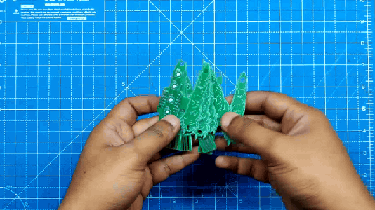

Step 2: Seeed's Fusion Service
After the completion of PCB Design Process, we uploaded the gerber data for the PCB to Seeed's Fusion Site and ordered few Boards with Green Solder mask.
PCBs were received in a week, and their quality was super good considering the rate, which was also pretty low.
Seeed Fusion PCB Service offers one-stop prototyping for PCB manufacture and PCB assembly, and as a result, they produce superior-quality PCBs and fast turnkey PCBAs within 7 working days.
Seeed Studio Fusion PCB Assembly Service takes care of the entire fabrication process, from Seeed Studio Fusion Agile manufacturing and hardware customization to parts sourcing, assembly, and testing services, so you can be sure that they are getting a quality product.
After gauging market interest and verifying a working prototype, Seeed Propagate Service can help you bring the product to market with professional guidance and a strong network of connections

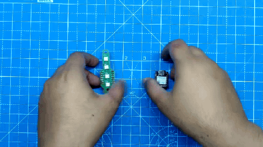

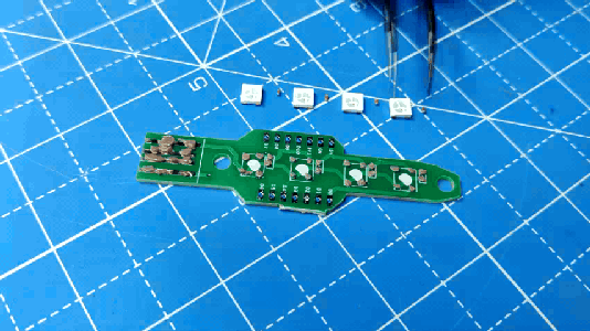

Step 3: PCB Assembly Process
  • Using a solder paste dispensing syringe, the solder paste is first added to the PCB during PCB assembly.
  • Next, we pick and place all the SMD components in their places using an ESD tweezer.
  • Following the pick and place procedure, we placed the PCB on the SMT Reflow hotplate, which heats the board from below to the melting point of the solder paste. The solder melts at that temperature, soldering every component to its pad.
  • The THT process followed next, which starts by placing the header pins in the XIAO Pads.
  • Using a soldering iron, we soldered the pads of the header pins, securing them in place.
  • At last, we added the XIAO ESP32 C3 in its place on the header pin, and the PCB assembly has been completed.

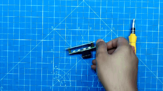

Step 4: Final Assembly

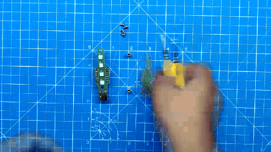

We're using two M3 PCB standoffs, each 10 mm tall, to secure both PCBs together.
We start by adding the M3 PCB standoffs to the main board using two M3 bolts.
Next, we place the finger PCB on top of the PCB standoffs and secure it using two M3 bolts.
The assembly has been completed.

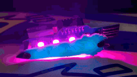

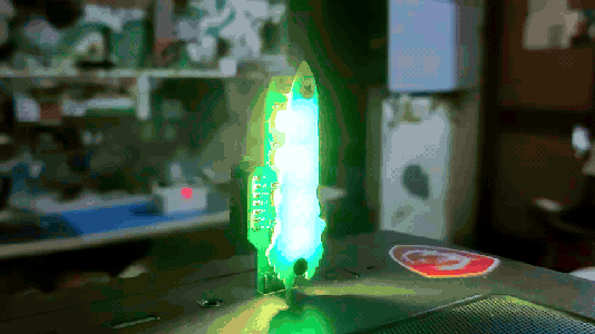

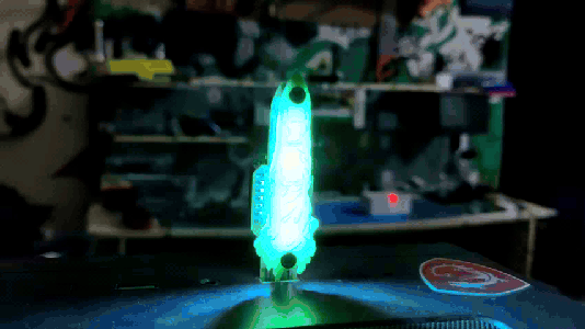

Step 7: Result
Here's the result of this simple yet fun build: a working Glowing Sukuna's cursed finger made completely from scratch using custom PCBs and the XIAO ESP32 C3 MCU.

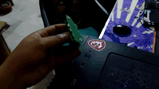

We can add this device anywhere where there's any USB port. For example, we can attach this board to a TV or monitor, and it will glow up the background of the monitor or TV, which will look pretty good and be aesthetic.
We can also connect this board to a smartphone charger's USB port and use this device as an RGB lamp.
Overall, this project is working and requires no further revisions.
