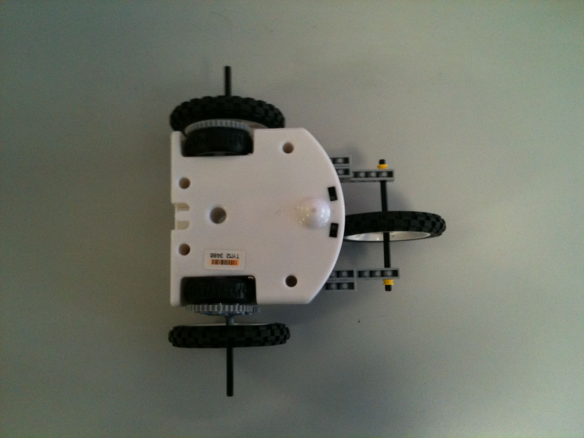

Step 1: Step One: Gather the Legos for Part One
Gather the Following Legos you see in the picture
Step 2: Legos Added
Put your legos in the spots show in the picture.
Step 3: Add the Following Legos
This includes an image of the final thymio, and the legos needed to finish it.

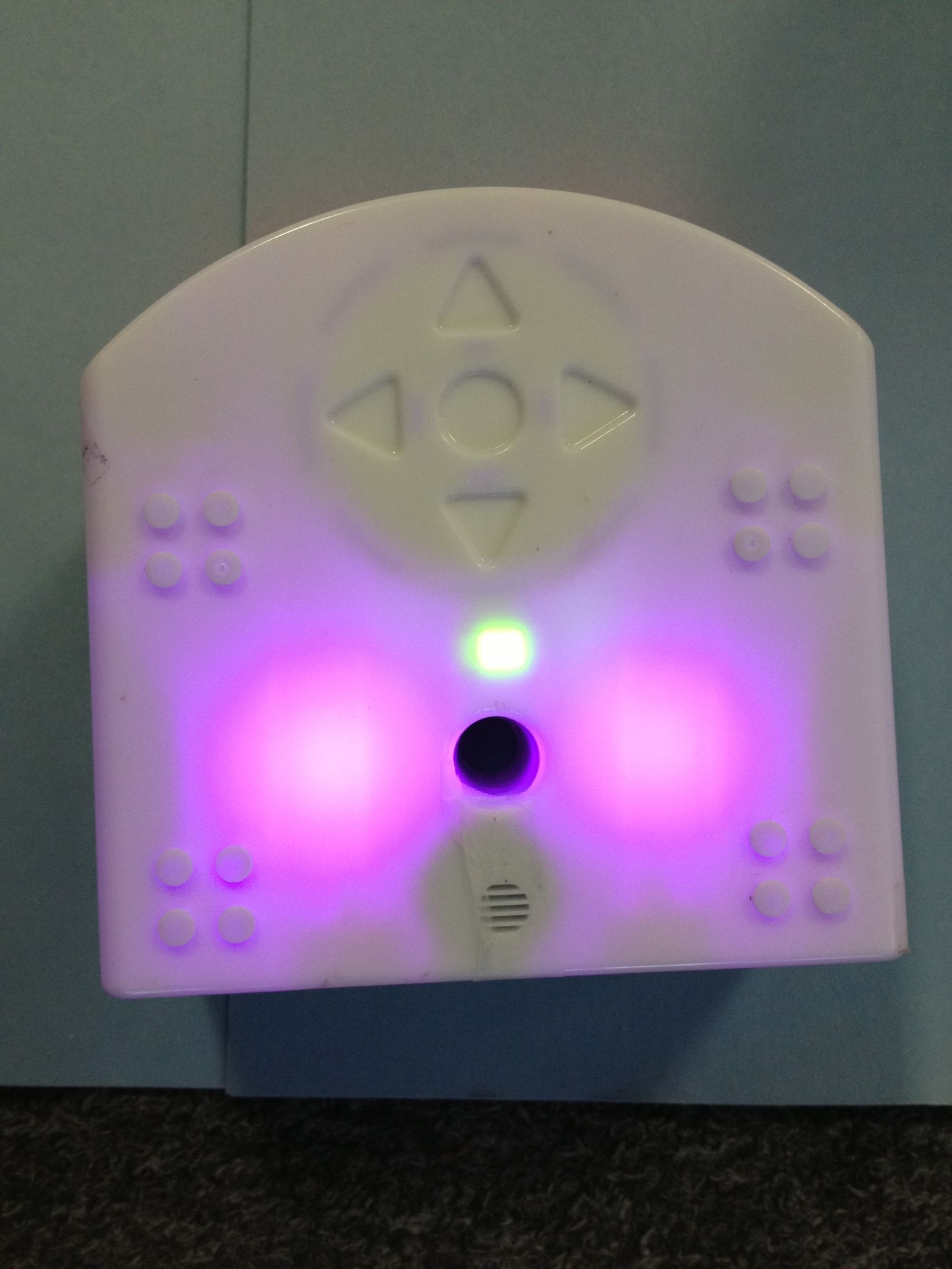

Step 4: Program!!
Time to program thymio. Use this code.
