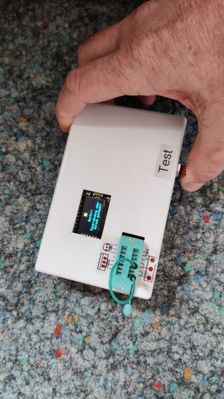

Introduction: Thyristor/Triac Tester
Alles ausser Thyristoren & Triacs kann der LCR-TC2 testen.
Darum habe ich einen Thyristor&Triac Tester entwickelt.
Realisiert mit einem nodeMCU ESP8266 mit OLED (Ideaspark ESP-12E)
Das Schema ist auch dabei (zum Selbstverständnis).
Mehr Info ist eigentlich nicht nötig.
Das Projekt ist durchgetestet!
Testing thyristors and triacs is the only thing the LCR-TC2 cannot do.
So here is a thyristor & triac tester.
Achieved with an nodeMCU ESP8266 with OLED (Ideaspark ESP-12E)
The schematic is also included (for your own understanding).
More information is not really necessary.
The project is thoroughly tested!
Step 1:
Build the main and intermediate PCB as attached.
Since the test socket has to be higher and the legs are too short to be firmly inserted into
a pin header, I have created a small intermediate PCB.
Gerber file for main PCB:
https://www.xup.in/dl,94371325/gerber1.zip/
Gerber file for intermediate PCB:
https://www.xup.in/dl,11709578/gerber2.zip/
Equip these (see stueckliste.txt) and flash the ESP with the attached ino file above. Use Arduino IDE ( https://randomnerdtutorials.com/how-to-install-esp8266-board-arduino-ide/ ).

The StepUp must be set to 18V!
I have attached the Target3001! file (thyristor_triac_tester_2lagen_V1.1.txt > rename it to thyristor_triac_tester_2lagen_V1.1.T3001) for testing purposes.
Target3001! Discover is for free ( https://server.ibfriedrich.com/wiki/ibfwikide/index.php/TARGET_3001! ).
display.dxf and ic_sockel.dxf is for the cut-outs in the housing.
Everything can also be found on github: https://github.com/ltspicer/Thyristor-Triac-Tester
