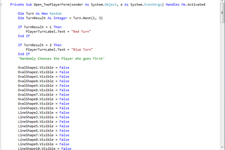

Step 3: When the Game Starts
33. Now the coding for deciding the turn:
Private Sub Open_TwoPlayerForm(sender As System.Object, e As System.EventArgs) Handles Me.Activated
End Sub
‘This is the code for what happens when the TwoPlayerForm is opened.’
34. Insert following code in between Private Sub and End Sub:
Dim Turn As New Random
Dim TurnResult As Integer = Turn.Next(1, 3)
If TurnResult = 1 Then
PlayerTurnLabel.Text = “Red Turn”
End If
If TurnResult = 2 Then
PlayerTurnLabel.Text = “Blue Turn”
End If
‘Randomly chooses the player who goes first.’
OvalShape1.Visible = False
OvalShape2.Visible = False
OvalShape3.Visible = False
OvalShape4.Visible = False
OvalShape5.Visible = False
OvalShape6.Visible = False
OvalShape7.Visible = False
OvalShape8.Visible = False
OvalShape9.Visible = False
LineShape1.Visible = False
LineShape2.Visible = False
LineShape3.Visible = False
LineShape4.Visible = False
LineShape5.Visible = False
LineShape6.Visible = False
LineShape7.Visible = False
LineShape8.Visible = False
LineShape9.Visible = False
LineShape10.Visible = False
LineShape11.Visible = False
LineShape12.Visible = False
LineShape13.Visible = False
LineShape14.Visible = False
LineShape15.Visible = False
LineShape16.Visible = False
LineShape17.Visible = False
LineShape18.Visible = False
‘Makes ALL circles and crosses Invisible.’

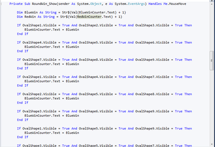

Step 5: The Win Counter
38. Now we want to program the wins, so we will name the Strings “BlueWin” and “RedWin” under a new Private Sub.
Private Sub RoundWin_Show(sender As System.Object, e As System.EventArgs) Handles Me.MouseMove
End Sub
‘This is the code that will happen when the mouse is moved.’
39. Insert the following code in between the Private Sub and End Sub
Dim BlueWin As String = Str$(Val(BlueWinCounter.Text) + 1)
Dim RedWin As String = Str$(Val(RedWinCounter.Text) + 1)
‘This is the code that makes BlueWin and RedWin a String. If the Event happens it will add +1 score to the Player.’
40. The Following code is the wins.
If OvalShape1.Visible = True And OvalShape2.Visible = True And OvalShape3.Visible = True Then
BlueWinCounter.Text = BlueWin
End If
If OvalShape4.Visible = True And OvalShape5.Visible = True And OvalShape6.Visible = True Then
End If
If OvalShape7.Visible = True And OvalShape8.Visible = True And OvalShape9.Visible = True Then
End If
If OvalShape1.Visible = True And OvalShape4.Visible = True And OvalShape7.Visible = True Then
End If
If OvalShape2.Visible = True And OvalShape5.Visible = True And OvalShape8.Visible = True Then
End If
If OvalShape3.Visible = True And OvalShape6.Visible = True And OvalShape9.Visible = True Then
End If
If OvalShape1.Visible = True And OvalShape5.Visible = True And OvalShape9.Visible = True Then
End If
If OvalShape3.Visible = True And OvalShape5.Visible = True And OvalShape7.Visible = True Then
End If
If LineShape1.Visible And LineShape3.Visible And LineShape5.Visible = True Then
RedWinCounter.Text = RedWin
End If
If LineShape7.Visible And LineShape9.Visible And LineShape11.Visible = True Then
End If
If LineShape13.Visible And LineShape15.Visible And LineShape17.Visible = True Then
End If
If LineShape1.Visible And LineShape7.Visible And LineShape13.Visible = True Then
End If
If LineShape3.Visible And LineShape9.Visible And LineShape15.Visible = True Then
End If
If LineShape5.Visible And LineShape11.Visible And LineShape17.Visible = True Then
End If
If LineShape1.Visible And LineShape9.Visible And LineShape17.Visible = True Then
End If
If LineShape5.Visible And LineShape9.Visible And LineShape13.Visible = True Then
End If
'Adds 1 to the Win counter if there is a 3 in a row'
41. Insert the following code underneath the previous code entered:
If OvalShape1.Visible = True And OvalShape2.Visible = True And OvalShape3.Visible = True Or
OvalShape4.Visible = True And OvalShape5.Visible = True And OvalShape6.Visible = True Or
OvalShape7.Visible = True And OvalShape8.Visible = True And OvalShape9.Visible = True Or
OvalShape1.Visible = True And OvalShape4.Visible = True And OvalShape7.Visible = True Or
OvalShape2.Visible = True And OvalShape5.Visible = True And OvalShape8.Visible = True Or
OvalShape3.Visible = True And OvalShape6.Visible = True And OvalShape9.Visible = True Or
OvalShape1.Visible = True And OvalShape5.Visible = True And OvalShape9.Visible = True Or
OvalShape3.Visible = True And OvalShape5.Visible = True And OvalShape7.Visible = True Or
LineShape1.Visible = True And LineShape3.Visible = True And OvalShape5.Visible = True Or
LineShape7.Visible = True And LineShape9.Visible = True And LineShape11.Visible = True Or
LineShape13.Visible = True And LineShape15.Visible = True And LineShape17.Visible = True Or
LineShape1.Visible = True And LineShape7.Visible = True And LineShape13.Visible = True Or
LineShape3.Visible = True And LineShape9.Visible = True And LineShape15.Visible = True Or
LineShape5.Visible = True And LineShape11.Visible = True And LineShape17.Visible = True Or
LineShape1.Visible = True And LineShape9.Visible = True And LineShape17.Visible = True Or
LineShape5.Visible = True And LineShape9.Visible = True And LineShape13.Visible = True Or
RectangleShape1.Enabled = False And RectangleShape2.Enabled = False And RectangleShape3.Enabled = False And RectangleShape4.Enabled = False And RectangleShape5.Enabled = False And RectangleShape6.Enabled = False And RectangleShape7.Enabled = False And RectangleShape8.Enabled = False And RectangleShape9.Enabled = False Then
'These are all the possibilities of a win'
'Makes all Circles and Crosses Invisible'
RectangleShape1.Enabled = True
RectangleShape2.Enabled = True
RectangleShape3.Enabled = True
RectangleShape4.Enabled = True
RectangleShape5.Enabled = True
RectangleShape6.Enabled = True
RectangleShape7.Enabled = True
RectangleShape8.Enabled = True
RectangleShape9.Enabled = True
'This Enables the Boxes again'
End If
'If there is a win then the game board is reset'
42. Debug the game and fix any errors found.
