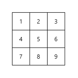

I drew the position number on the M5Stack and the respective mark was to be placed on the specified position in the 3x3 grid. The handwritten digit would be predicted by the Neuton TinyML model and the model's output would be passed on to the Python program.

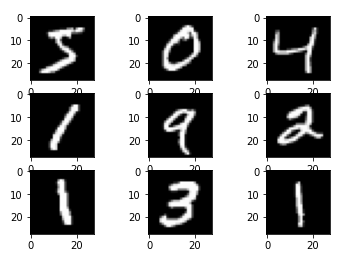

The MNIST (Modified National Institute of Standards and Technology) dataset is the "hello world" dataset of computer vision, sourced from the MNIST database which is a large collection of handwritten digits. Each sample is a 28x28 grayscale image of a hand-drawn digit between 0 and 9. There are 784 pixels in total and each pixel value indicates the lightness/darkness of the respective pixel. A higher pixel value means the pixel is dark and if it's low – the pixel is light. The pixel value has a range of 0-255 (inclusive).
Neuton already has pre-trained datasets that are ready for deployment and the MNIST dataset is one of them. The training dataset contains 42, 000 samples while the test dataset contains 28, 000 samples. The target variable of the training dataset is the 'label' variable which contains the digit that should be recognized and the feature variables are the pixel locations which contain the pixel values of the respective pixels.
The pixel location of a pixel is calculated using the following formula:
x = i * 28 + j
x is the pixel location. I and j are integers between 0 and 27 (inclusive). I denotes the pixel's row while j denotes the pixel's column and the indexing is by zero.

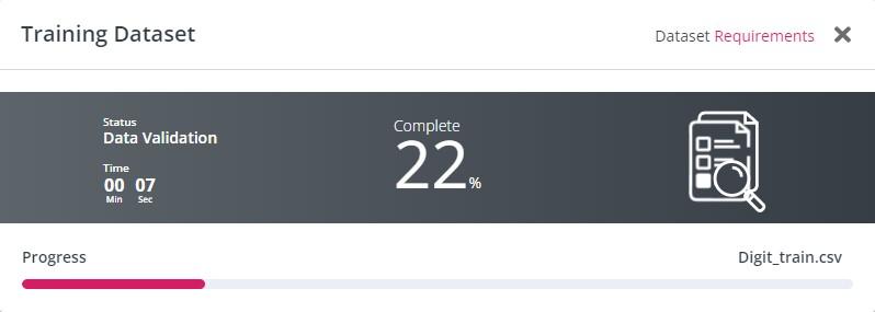

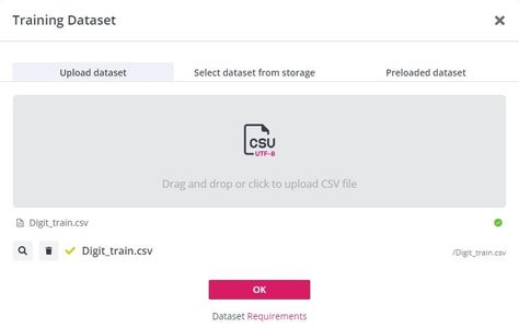

Once you are done, click ‘Next’ and you will be required to upload your training dataset. The dataset will be validated and if it meets all requirements, it will show a green tick and allow you to continue. You should not have duplicate rows or any missing values.
Click ‘OK’ and proceed to the next step. Choose your target variable which is the 'Label' variable and if you want to eliminate any other variables, you can also do that.

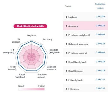

My model had an accuracy of 87.5% and a model quality index of 88%. I am satisfied with the results!

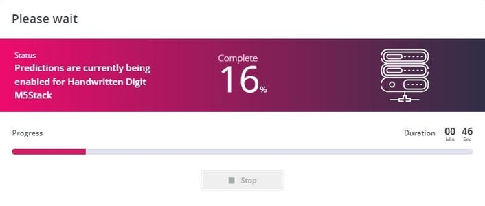

I enabled prediction to see how well my model performed. For this, I used my test dataset.
The results were better than expected and I felt quite confident about my TinyML model. I downloaded the C library and got ready to deploy it on my M5Stack.

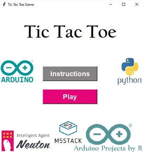

In this section, I will be explaining how I created the homepage of this game. You will need the font module to format the button text and this is completely optional. I set the background image as a label. To use an image in Tkinter, you will need to use the PhotoImage function. Make sure that the image is in.png format. If you want to use a different image format, you will need the PIL library and as it is not a standard library, you should install it.
I have used the button widget to create the Instructions and Play buttons. I also set the foreground and background colors using hex codes. The command is a function that will be called once you press the button. In this case, the play button should destroy the homepage and import the Python file which contains the codes for the game.
The instructions page is programmed within a function so there won't be any requirement to import a Python file for this case. You only have to create the button widget to play the game and the others are part of the background image.

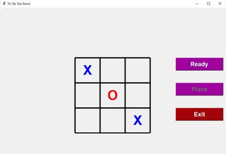

Use the canvas widget to draw out the 3x3 grid as shown in the pictures above.
You have three buttons here so you will need to create three-button widgets and, as mentioned in the previous section, you will need three functions for these buttons to implement when they are pressed.
I will first explain the functions because the functions should be defined before creating the buttons.
You will first define the function that will be called when the 'Ready' button is pressed. Your M5Stack will communicate with the Python application via a serial communication port. In the Arduino code, I programmed my M5Stack to print the model prediction output as a line in the Serial monitor. In this Python file, you will have the read the serial input. time.sleep(2) sets a delay period of 2 seconds.
You can check the datatype of your Arduino Serial input using the type() function and it will show that the input is encoded in UTF-8 format. I will need the serial_input as a string so I have decoded it and converted it to a string.
Now, you will need to define the function that will be called when the 'Place' button is pressed. First, you have to check if a specific digit is in the serial_input variable to place the mark in the respective position. Then, you have to check if the digit is in the positions list to verify that the position is not occupied. If the position is already occupied, you have to display an error message and if it is not, you have to proceed to check if the position list's length is even or not - xo_decision( ). Nought and cross will be determined after calculating the position list's length at each turn. Player 1 will get the cross mark while player 2 will get the nought mark.
Initially, the position list will be empty so when the length is calculated, it will return 0. 0 is even, so I have programmed this application to assign a cross as the mark if the position length is even. If it's not, the mark is a nought. Place your mark at the respective coordinates (depends on your grid coordinates). The position number should be appended to the position list and the label should be configured to show no text at all. If there's an error message, then doing this will remove the error message from the Tkinter window.
Repeat this step for all the nine digits.
To check if the length is even or not, you will need to use the modulo operator which returns the remainder of the integer division. You would have noticed that the cross is blue whereas the nought is red. We will be assigning the colors based on the result of this conditional programming.
The 'Ready' button is pressed when the user is ready to draw the digit and as soon as the input is received, the 'Place' button should be enabled. You may now know how to create a button widget after reading it in the previous section but this time, you will have to access another property to enable/ disable the button state. As soon as the 'Place' button is enabled, the 'Ready' button should be disabled. You can change the state of the buttons using.configure( ). You should include this in the buttons' functions after creating the button widgets.
When the 'Place' button is enabled, you can click on it to place your mark. Once your mark is placed, the 'Ready' button should be enabled and the 'Place' button should be disabled again.

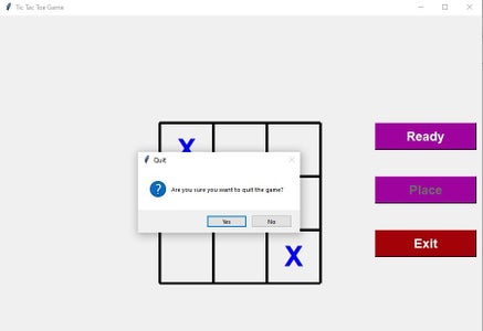

As visible in the second picture, the 'Exit' button's function should display a question-type message asking the user if they are sure about quitting the game when the 'Exit' button is pressed. If the user clicks the 'Yes' button, then the game window should disappear.

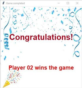

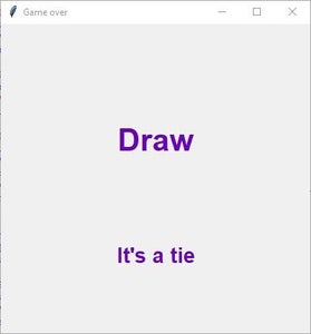

Step 11: P1.py, P2.py and Draw.py
The three files will have similar codes. You can create a Tkinter window and apply a background image showing the result.
