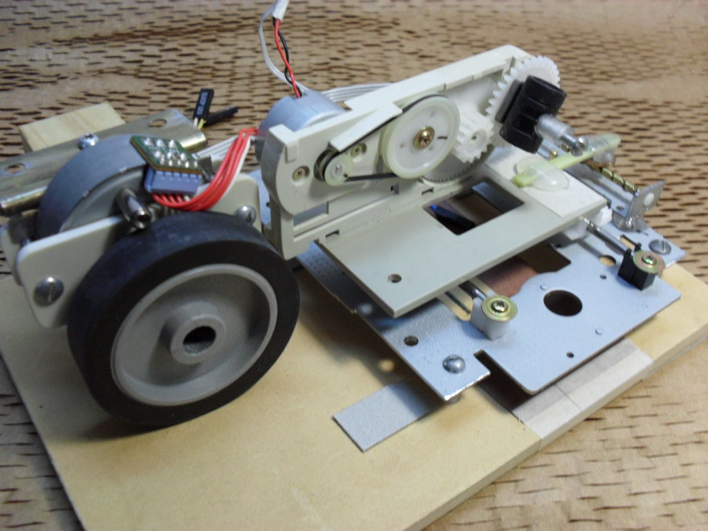

Basically you just need a dead printer and a dead DVD reader. The motor witch works with the cartridges in the printer and the one witch works with the laser in the DVD reader have to be bipolar steppers motors, so be sure of that.
The plastic parts where taken from the plastic of the printer, be sure to find some straight sheets a cut them from there.

The cartridge tray of my printer was the only part made of metal and it was pretty easy to took it out.
Once out I removed the cartridges and cut the platform in order to make it flat, here is where the board will rest.
Finally add two pieces of plastic in the borders for stabilization.
