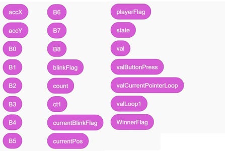

Before starting with the code let me tell you about some of the important variables used:
- State : This is going to store the state of all the 9 positions and it is initialized with the value 333333333 where each 3 represents that the position is empty and as the game goes, players lock their positions so the state variable will store either 1 or 2 at the respective position.
- PlayerFlag : It is used to determine the current player, it gets updated between 1 or 2 as the game goes and the winner gets the chance to start the next game. If a game ends with a tie then the opponent player gets a chance to start the next match.
- WinnerFlag : It is used to determine whether the game is still going on and it determines it by updating itself with 2 as soon as one of the players wins or when the game is a tie it changes to 3.
- currentPos : It is used to choose the desired position to lock and it gets updated based on the tilt angles of the Micro Bit. it can be from 0 to 8 as shown in the figure.
- currentBlinkFlag / BlinkFlag : The blink flags are used to create a slow or fast blinking pattern to allow differentiate between the players or the current position which is going to be chosen
- Count : it is used to determine the total number of places blocked by the players and it is mainly utilized to determine the tie game.
- B0 - B8 : These will extract the 9 positions from the state variable to determine the winning pattern when any of the player plays his/her move.
- accX / accY : These are storing the data from accelerometer in x axis and y axis to determine the current desired position of the player in 3X3 Grid.

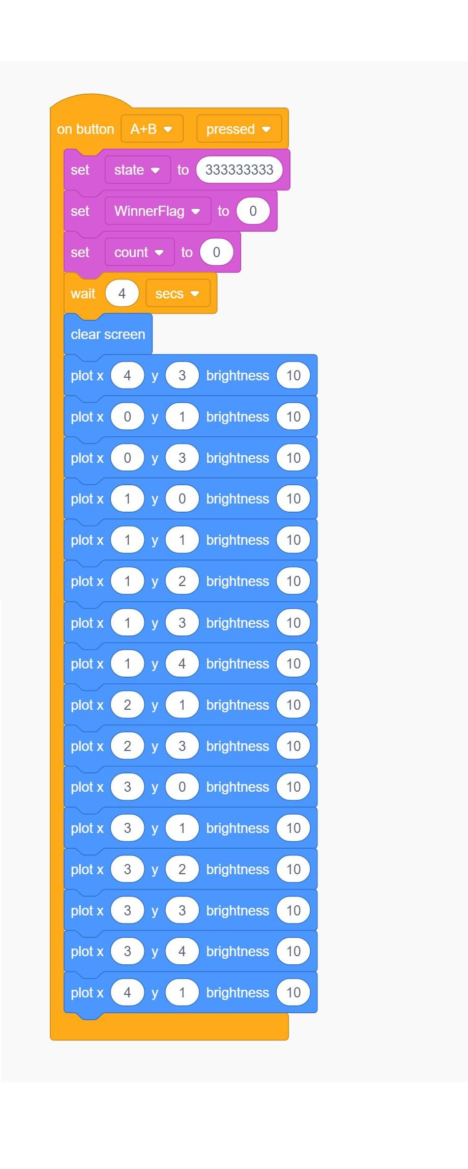

When the game either gets tie or anyone wins you can press buttons A and B together to reset the game and this blocks does that by simply overwriting the variables with fresh values and clearing the screen and redrawing the grid on the screen.
