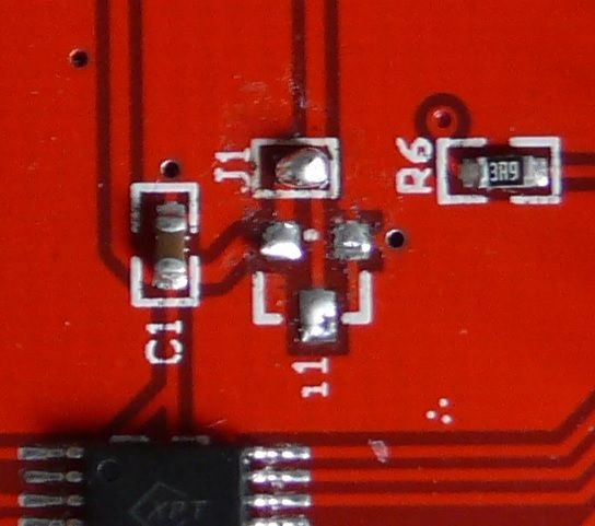

Then I wired it up using my new board holding an ESP-12F – and it worked. The only change I had made was to short out the voltage regulator on the display module so all was driven at 3.3v. I started doing my code mods, particularly code to put the display chip (ILI9341) into sleep mode as this and the touch panel chip would need to powered (in sleep mode) when the ESP module is also in sleep. I then checked the sleep current. This was 90uA. So a 1000mah battery would last a year. Good start.
Then I removed the voltage regulator on the display module. It would have been enough to have just lifted the ground pin. Now the system sleep current was 32uA. I still had to add a 3.3v regulator but knew one with just 2uA quiescent current. So now we are looking at 3 years battery life!

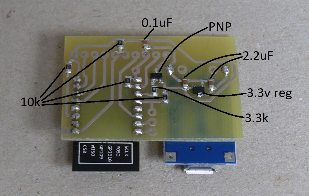

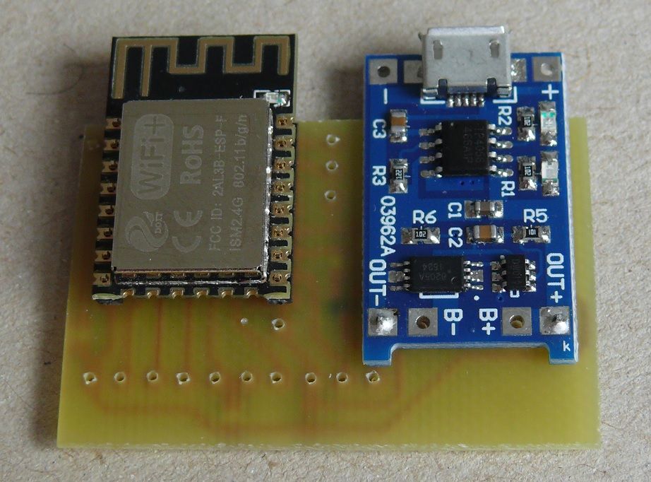

The unit I built here uses a PCB to hold the ESP12F and charger modules and the voltage regulator and PNP transistor and the associated capacitors and pull-up resistors. This is the neatest route, but requires PCB etching and SMD soldering equipment. However the system could be made by wiring the modules directly and putting the voltage regulator and PNP transistor onto a piece of stripboard – as was the case in the earlier TicTac project (linked earlier).

  • PNP transistor in SOT23 format. I used BCW30 but any other with more than 100ma capability and DC gain>200 should be OK.
  • 3v3 250ma(min) regulator in SOT23 format. I used Microchip MCP1703T-33002E/CB. Others will work but check their quiescent current. (suggest less than 30uA).
  • Resistors (all 0805 size)
  • 10k 4off
  • 3k3 1 off

When assembling the PCB do the resistors and capacitors first, then the regulator and PNP transistor, followed by the charger module and the pin-strip for the ESP12. I didn’t solder the ESP12 in place as it is firm enough pressed onto the pin-strip, and it is easier to reprogram off the board. You will notice that the PCB has connectors for TX, RX, GPIO 0, Reset and ground if you ever want to reprogram in-situ. Note that a button will be required to pull GPIO low. Reset can be pulled low by touching the display. A button could be used but only if the wire to the display T_IRQ is disconnected.

Before wiring the display to the circuit board remove the regulator i1 and put a blob of solder on J1 that then replaces this. Afterwards it should look like:

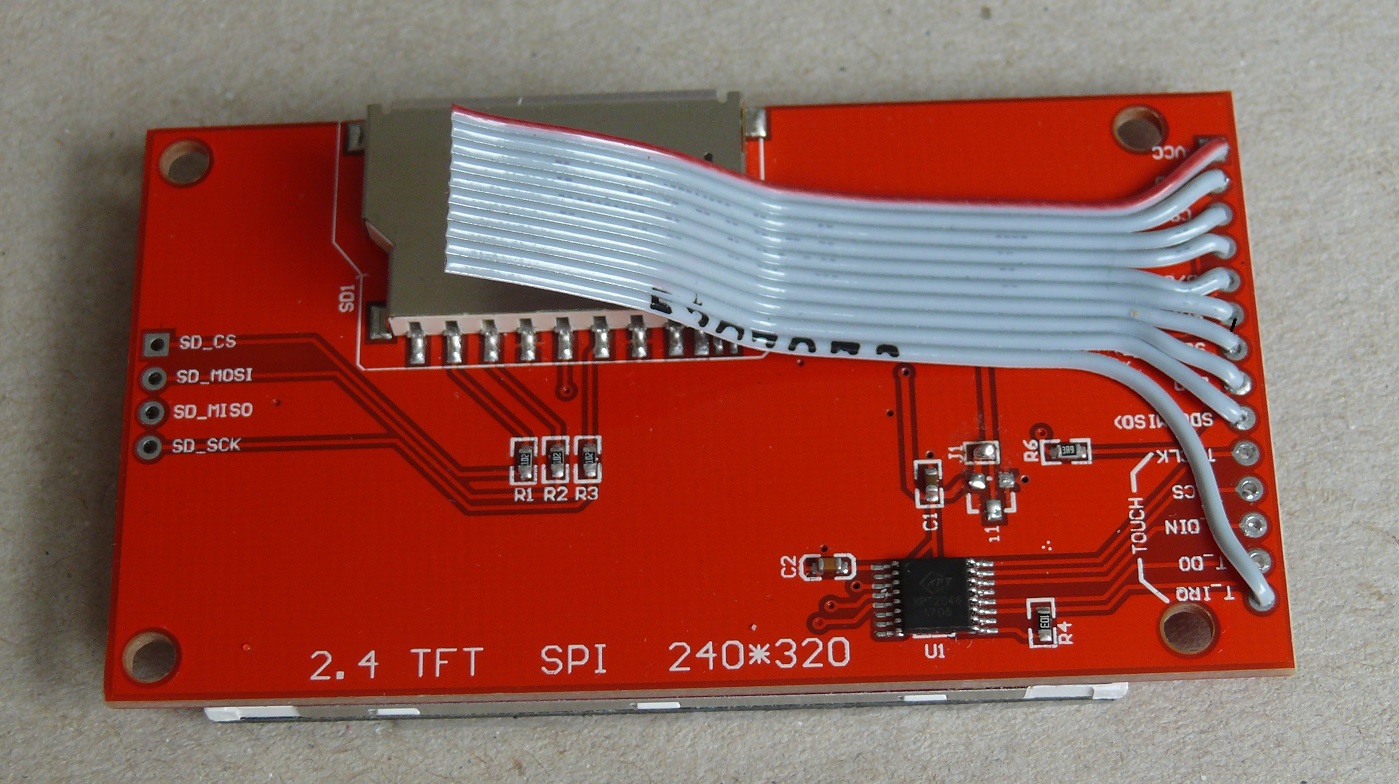

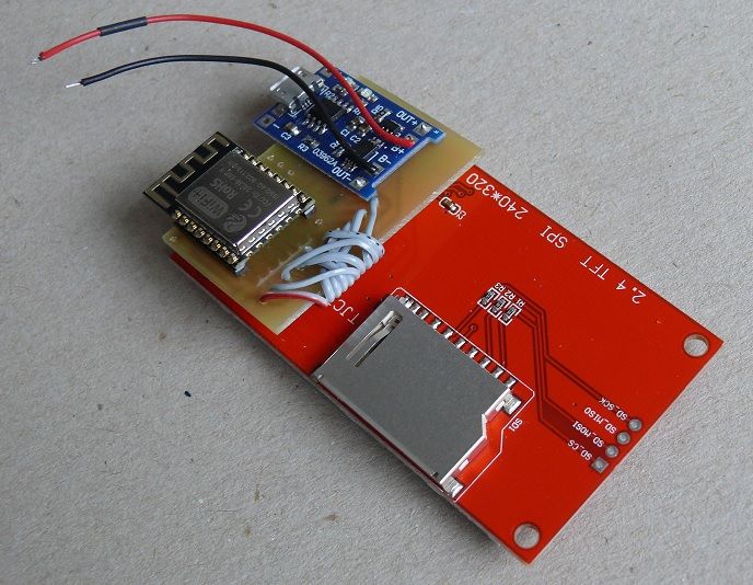

Now the wiring can start, beginning with connecting ribbon cable to the display. Cut around a 7-8cm length of PC ribbon cable and select 10 ways. Trim 9 of the ways back 10mm leaving one longer one at one edge for the T-IRQ pin. The rest can then be splayed out to where they will be soldered and trimmed a bit more where necessary.
I placed and soldered one lead at a time starting with VCC.
Place the PCB where it needs to be in relation to the display. Then, one at a time, trim the wires to 5mm or so longer than required and strip 2mm insulation, tin the end and solder in place. The wire routing goes as follows (counting pin numbers from VCC):
DisplayPCBComment
11VCC
28GND
39CS
45RESET
57D/C
62SDI(MOSI)
74SCK
810LED
93SDO(MISO)
106T_IRQ

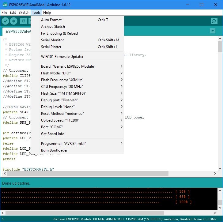

Then set the programming details (Tools):
Select board: Generic ESP8266 Module
See below for the rest of the settings. Select Reset method: “nodemcu” if using a programmer with the automated drive of the reset and GPIO0. Otherwise set to “ck” if programming in-situ or by direct connection to a USB to serial converter.
The Port number is likely to be different.

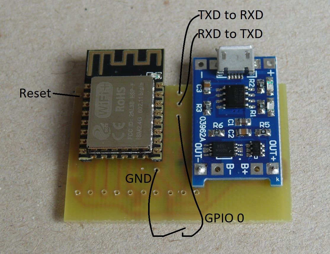

If you want to program in-situ you will need to solder wires to a switch to pull GPIO 0 low and connect to the Tx and Rx – see below:
An easier option is to use a programming board:ESP-12E and ESP-12F Programming and Breakout Board
If programming in-situ connect as below. Note if the display is connected Reset can be activated by the touch screen, otherwise a switch is needed from Reset to GND. Power is needed to the board, best by applying 3.7v to the OUT+ and OUT- pins. If using a battery the charger needs to be reset by briefly plugging in a USB lead.
If setting the programming mode manually pull reset low (touch screen), pull GPIO 0 low and while low release the reset. Now click the download button. The programming should proceed.

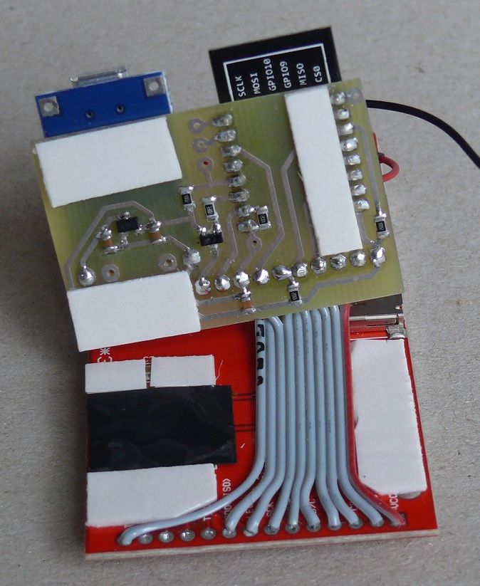

The circuit board has to be fixed to the display board in order to both fit inside the cap and present the USB charging socket. When the required relationship between the board positions is seen then place double sided tape (the 1mm thick type) to both boards. This will give a 2mm clearance that should avoid any electrical contact. I placed some insulating tape covering the display electronics as a precaution:

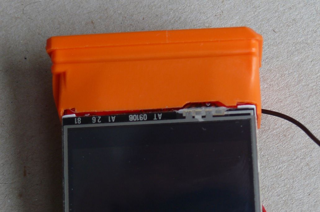

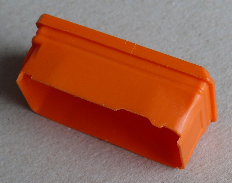

Next we need to take around 2mm off the top cap. I made this a snug fit to the screen with extra bits cut out for the touch screen ribbon cable and the screen plastic mount. See below:

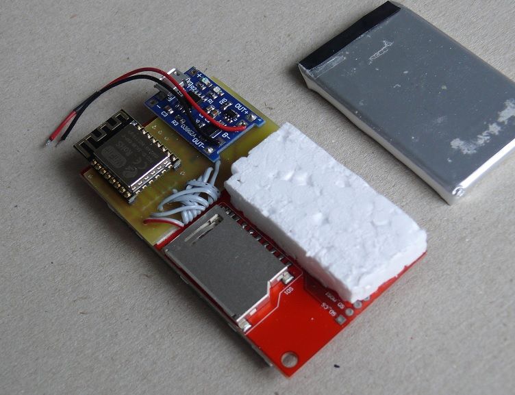

Lastly we need to place the battery and use this to hold the display against the box side. I used an old piece of polystyrene foam and cut and sanded it the to required thickness. I stuck this to the display PCB using thin double sided tape and used a couple of smaller pieces of tape to stop the battery sliding about.
When you have connected it all up and find that nothing happens, don’t worry (yet). The battery protection circuit on the charger module has to be reset. This is done by connecting it via a micro USB lead to a 5v supply. A few seconds is long enough.
