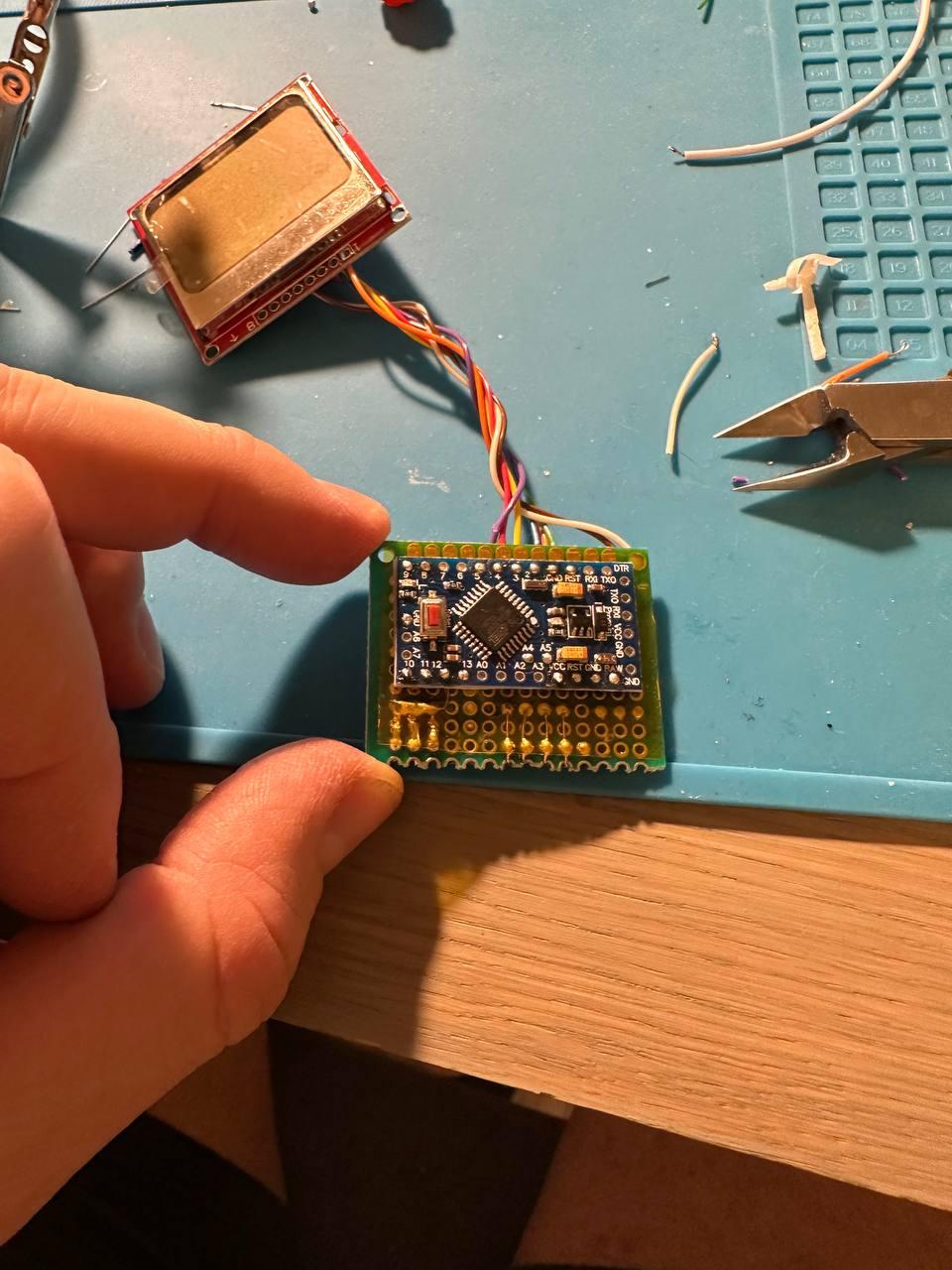

you need to solder all connections according to the diagram

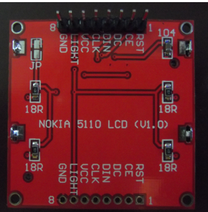

arduino  LCD
PIN8 -1K- SCLK;(CLK);(SCK);
PIN9 -1K-DIN;(SDIN);(MOSI);
PIN10 -1K- D/C;(DC);
PIN11 -1K- CS;(SCE) (CE);
PIN12 -1K- RST;(RESET);
VCC - VCC
GND -(a voltage divider look at the schema) GND
GND -330ohm LIGHT
Keys
arduino - keypad
pin4 (100ohm to ground) - enter (second pin to vcc)
pin3 (100ohm to ground) - left (second pin to vcc)
pin2 (100ohm to ground) - right (second pin to vcc)
I used an Arduino pro mini, there is no 3.3 volt output, I added a voltage divider to the circuit, so this connection should only be used if there is no 3.3 volt output

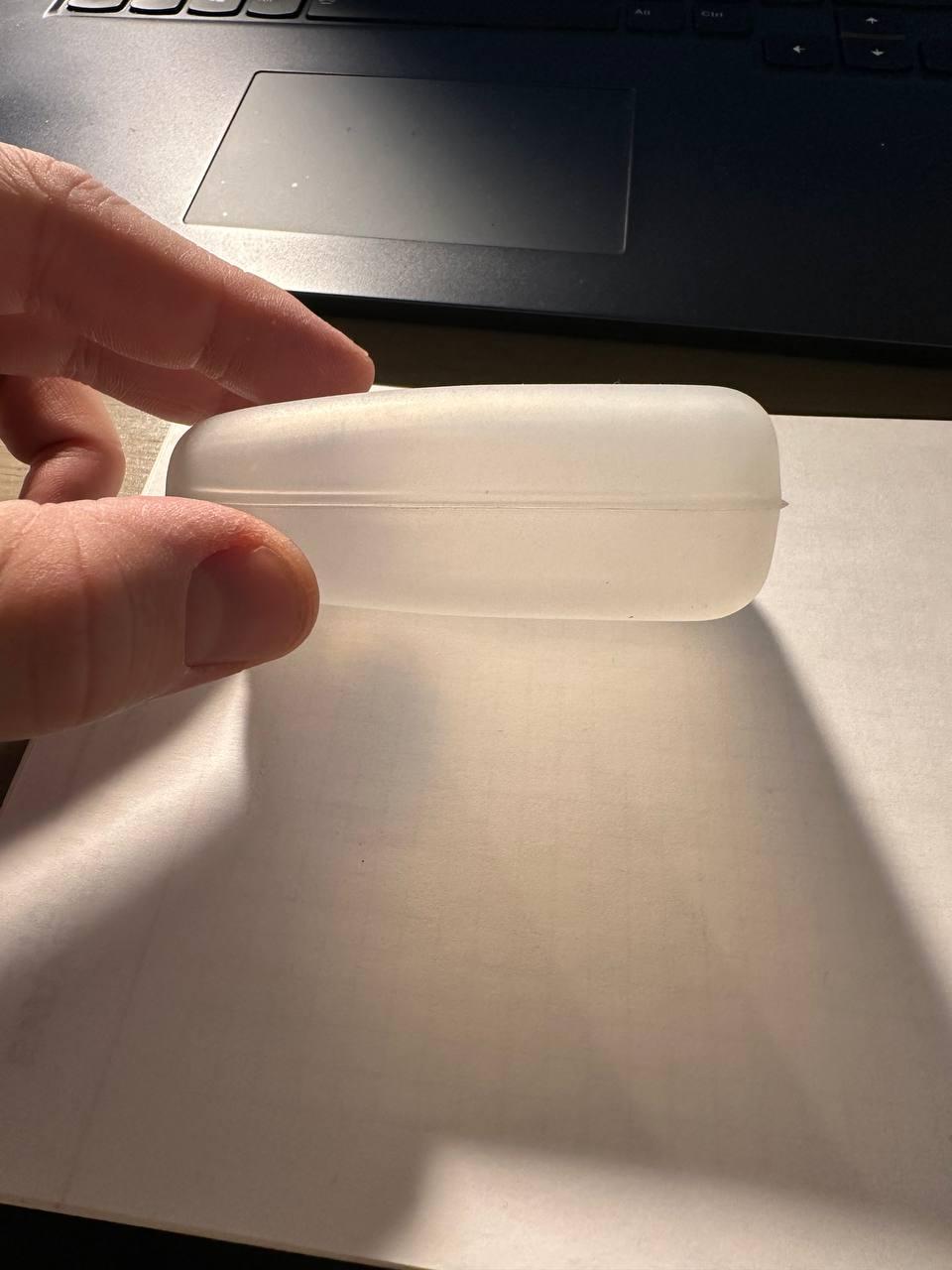

I found a suitable housing at home in which everything should fit and began to prepare it for the installation of all elements
Step 4:
After installing all the parts I checked everything, it works fine, if you have any questions, please ask
