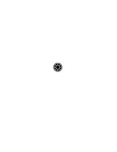

The Wings measure 90 mm tall
The Cockpit windows measures 17 mm round
The Wing Splines measure 90 mm tall
The Engine measures 14 mm round
