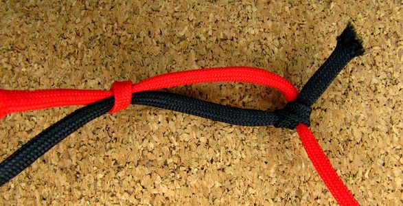

Step 5: Tie It
Some knots tied in nylon will slip; Here are a couple of reliable ones.
When joining two similar cords, Put the two ends together and tie them both together in a square knot.
When tying a 550 line around something, the Surgeon's knot is slip-resistant. This is tied like a square knot, but the running end goes through the loop twice instead of once.
I am not (Knot?) a knot expert, but these two knots will handle 90 percent of all situations.

    qwerty987
    qwerty987
    6 years ago on Step 5
    I think your first knot is actually a figure eight knot, here is a square knot which isnt as good with paracord.
