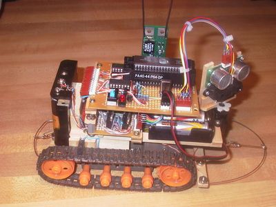

This was my first robot, built in 2002 when I was a freshman in college. I named it TiggerBot because it was black, orange, and stupid. It was flawed in several important ways. TiggerBot II is a substantial redesign; it uses the same treads kit but is superior in all other ways. Pictured below are the original TiggerBot, several obsolete TIggerBot II prototypes, and the current prototype.

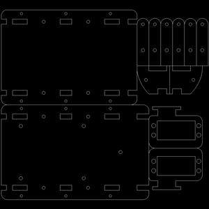

TiggerBot II's main components are all computer designed and custom manufactured.
The plastic components are designed in qcad. They are then separated, duplicated, packed together for efficiency, and printed as a 1:1 eps. This is sent to a plastic manufacturer to be cut from acrylic.

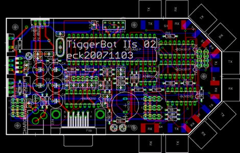

The circuit board is designed in eagle cad and manufactured by a pcb prototype supplier.

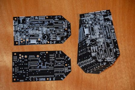

Step 3: Manufacturing
I have the circuit boards made by Gold Phoenix PCB in China and the acrylic cut by Canal Plastics in Chinatown NYC. Coincidental, really. The turnaround times are ~9 days and ~3 hours, respectively, which is probably why I've made a lot more frame revisions.
The boards cost $140 for 13, or ~$11 each. The frames are $59 at canal, or apparently $78 for 3, or $26 each, from ponoko, though I've never ordered from them. In any case Ponoko doesn't seem to have tinted transparent acrylic in 6mm.
This is the eps of the plastic: http://robotarmy.org/tb2files/frame06.eps

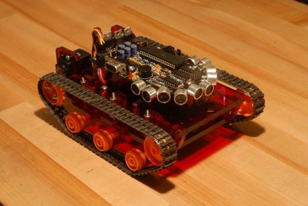

Attach four 3/4" 6-32 aluminum standoffs to the lower deck (the smaller one) using four 6-32 x 3/8" screws. Place the two servos in brackets and front wheel assemblies in the cutouts as shown. Place the top deck on and make sure all the tabs are properly inserted into the cutouts. Secure the top deck to the standoffs using four more 6-32 x 3/8" screws.
The color is different because this is a later prototype than the one in the earlier photos.

Step 24: Half Done
You have now completed the drive platform.

Step 25: Assemble Circuit Board
The circuit board pictured here is the last revision and has several mistakes. A new revision, which should fix most of the mistakes and greatly improve sonar performance is currently being manufactured. If you're considering building one of these I would strongly recommend that you wait until I have a chance to test the new version (pictured in cad-form below) and use that instead. They look very similar, however.
The circuit board here is designed with an avr microcontroller, power management, and a five channel sonar. It has everything required for doing simple stuff like wall following and obstacle avoidance. It is designed entirely with through-hole components so it is not especially hard to solder.
There are already a sufficient number of soldering howto guides on the internet so covering that here would be redundant. Figure 2 shows a closeup of several soldering styles you can choose from depending on whether you are building the 'robot' or 'paperweight' version. The components (see parts list) go where marked. It's not rocket science.
If you like, you can solder everything in one go. Otherwise, you can build the power supply first and verify that you get 5v out, then build the avr & serial port and make sure you can program it, then build the sonar.
