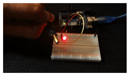

Step 1: How Does It Work
Here's how it works:
When the sensor is fully upright, the ball drops to the bottom of the sensor and connects the poles, allowing current to flow.
When the sensor is tilted, the ball does not touch the magnetic pole, the circuit is broken, and current does not flow.
In this way, the tilt sensor acts like a switch, turning it on or off depending on its tilt. Therefore, it will provide digital information to the Arduino, whether it is a high signal or a low signal.
Step 2: Pin Wiring
Connecting the tilt sensor to the Arduino is very simple. You just need to connect one pin to the Arduino digital pin and GND to GND. In this case, you just add an LED to the schematic in the "Pin Wiring" section.

Step 4: Finally
In the end, this is what you'll have.
