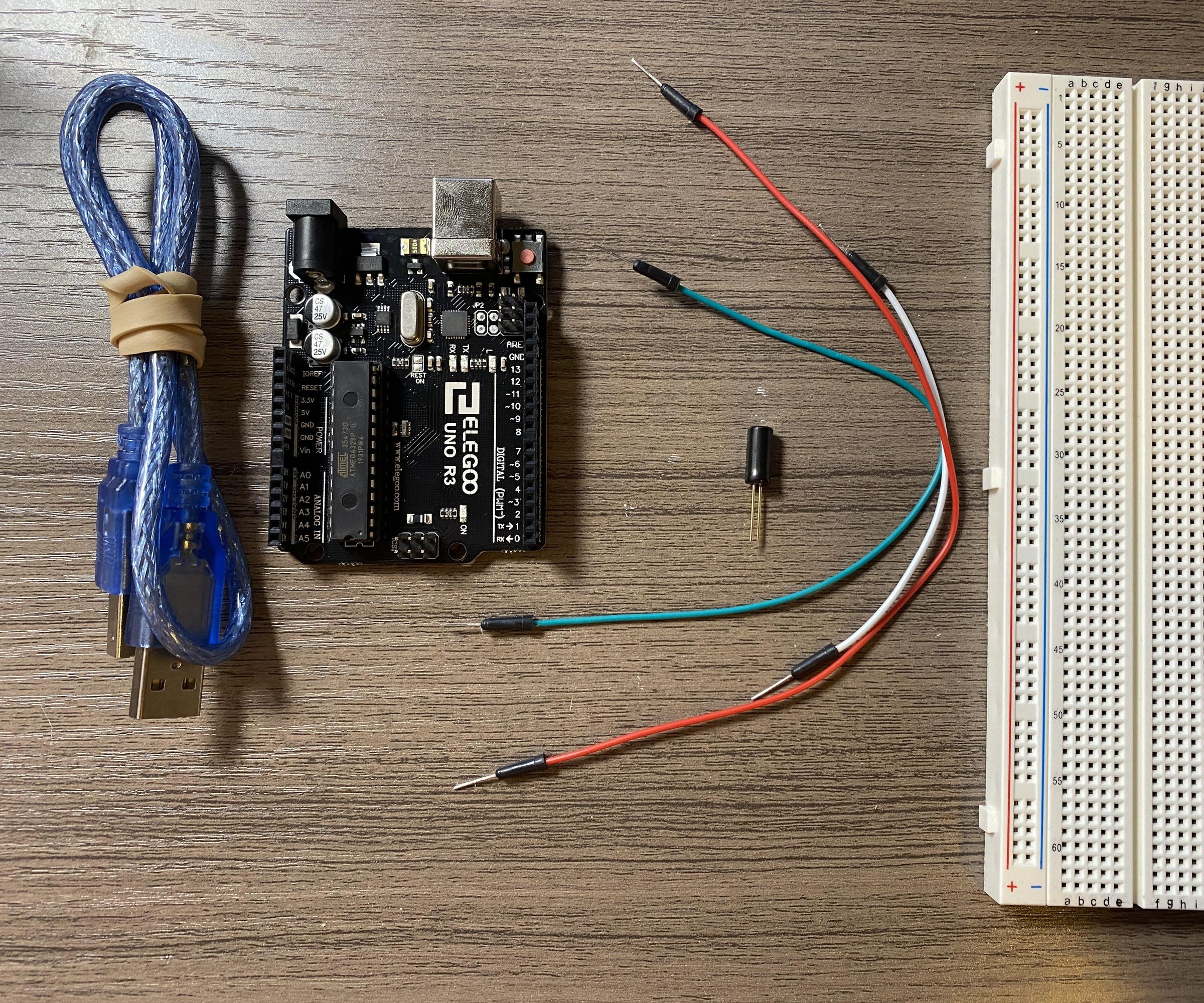

  • 1x Microcontroller
  • 1x USB cable
  • 4x Jumper Wires
  • 5x Female to Male jumper wires
  • 1x 100 - 1000 Capacitor
  • 1x 470 ohms resistor
  • 1x Tilt ball switch
  • 1x Addressable RGB led strip
Step 1: Setting Up Your Components
Follow the layout in the sketch above to assemble your components.
Please keep your microcontroller disconnected from the power source while putting your components together.
