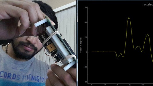

Introduction: Tilt Angle Visualization With Edison, Accelerometer and Python
I recently bought an Intel Edison arduino board. After blinking the on-board LED, I wanted to do something a bit more interesting but fairly simple. After reading up online, I decided on accelerometer based tilt sensing.
Why accelerometer you ask, well accelerometers are beginning to be used in a lot of new products (read fitbit, basis etc) and I was curious to learn how these sensors work and have some fun playing with them.
In this project, the Edison board connects to a computer over WiFi and
the computer displays a live plot of the board tilt angle. Connecting with WiFi helps free up the board so that it is not restricted by a wire connecting the board to the computer. This project has just seven components, the accelerometer is quite simple to use and the project can be easily built over a weekend. I hope that this will serve as a good starting point for other curious beginners.

Step 6: Calculate Tilt and Display
Tilt angle is calculated based on the acceleration measurements along X and Z axes.
From the figure above, we can see that angle is calculated as tan-inverse of (-Ax/Az).
There is a function in python called atan2 which takes two arguments and gives angle between -pi and pi radians based on the sign and ratio of the arguments. Below is a code snippet showing the angle calculation implementation.
# convert accelerometer readings to angle in radians and then convert radians to degrees angle = math.atan2(Ax, -1*Az) * (180 / math.pi)
Note that the sign for Ax and Az are reversed from that shown in the
figure. This is intentional. It is needed because when the accelerometer is mounted on Edison board as described earlier, the front-face of the accelerometer board which has the adxl335 chip, is facing downwards while in the figure, I have made the calculations assuming it faces upwards. I did not realize this until I had assembled everything and then testing it out. I apologize if this creates some confusion as a result of my oversight.
Display
For live display of tilt angle, we will be using PyQtGraph module. Here is a high level overview of how the display part works:
1) plot-area, axes etc are initialized
2) A function called update() is called recursively every 50 milli-seconds which starts a client socket, gets accelerometer data from server, processes it to calculate angle, displays on the graph and closes the socket. This occurs periodically every 50ms using a timer (called QTimer).
For more details regarding the software, please refer to the full implementation of client and server programs which I have uploaded in the next step.
