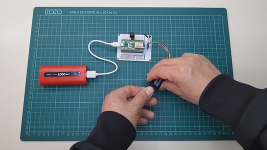

Introduction: Time Clock With Fingerprint IoT Module, Uploading Data to Thingspeak
In this tutorial we will see how to create a personal control reader/clock with esp32, a fingerprint reader sensor.
Step 1:
In this tutorial we will see how to create a personal control reader/clock with esp32, a fingerprint reader sensor. All the data will be uploaded to the cloud, through the services of thingspeak.com. The assembly of the electronic circuit, the detailed explanation of the source code and finally, the device will be tested will be included.

Open Smart fingerprint module
Download Manual –> R308-fingerprint-module-user-manual_English
Buzzer
Female pins
Male pins
PCB
Download gerber file –> Esp32_fingerprint_PCB
