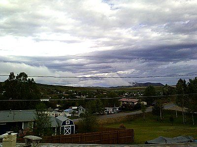

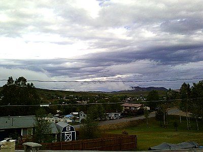

Find something interesting but which changes or moves slowly -- in this case, the weather. I stood in my backyard and took several pictures of the same general area, while standing in the same place.
As I'll show later on, having a steady hand is marginally important; just try to get the same general area in every shot. My technique in this particular case was to point the camera in such a way that the viewscreen showed the exact same object in the corner -- a small garden decoration -- in each shot.
Take as many as you like, until your arm gets tired, or until your camera runs out of memory! For this example, eleven shots will suffice. Make sure the shots are evenly timed, as good as you can. The more evenly-spaced they are, the smoother your animation will look in the end. For fast clouds, like here, I spaced the shots 2-3 seconds apart. For slow clouds, 5-10 seconds is better.

Look at the photos you took. Notice how, despite your best attempts, the pictures have a bit of a "wobble" due to the manner in which you took them. In my case, I was merely standing with my cell phone camera taking a bunch of shots. I didn't use a tripod or anything to stabilize my hand as I pressed the shutter release.
Try to find a picture that generally averages the positioning of the others. All the others seem to have captured landscape a bit to the left or the right of this one, or higher up or down. Open GIMP and drag this "average" photo into the blank window.
Find a place in the photo that is common among all the other pictures, like a bit of landscape that never moves. You want it to be small as well as easy to notice. The closer to the center of the picture this landmark is, the better. Hover your cursor over a specific pixel on that landmark and notice that GIMP tells you in the bottom-left corner the coordinates of that pixel. You may want to write it down.
