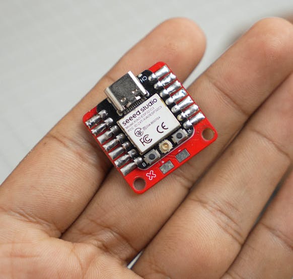

I also used my custom adapter PCB for XIAO ESP32C3
The XIAO ESP32-C3 was chosen for its small size, built-in Wi-Fi, and low power consumption, making it ideal for always-on display projects.

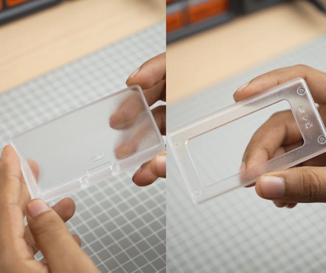

Step 1: Enclosure and 3D Printing
I used Fusion 360 to design the enclosure for this project. Then, I exported STL files for 3D printing.
The enclosure for the Time Since Wedding – E-Paper Clock was 3D printed using JLC3DP’s 3D printing service.
The design is simple and minimal to match the clean look of the e-paper display.JLC3DP offers multiple materials and finishes, allowing the enclosure to feel solid and look professional.

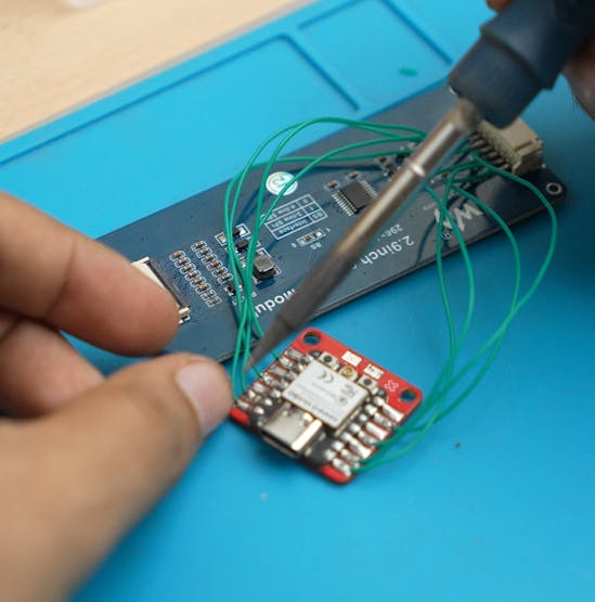

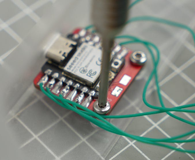

1. Solder the XIAO to the PCB adapter

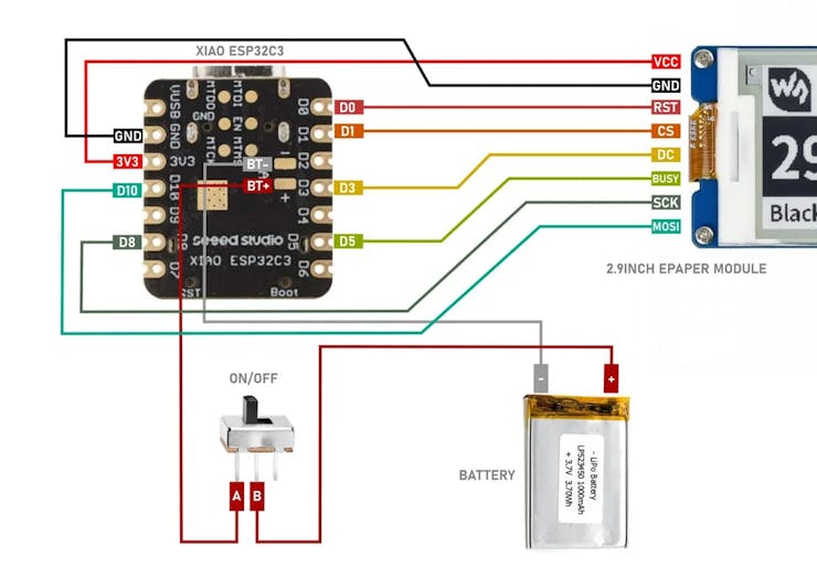

2. Connect the XIAO to the E-Paper module by following the wiring diagram provided. You can also see the battery connection in this diagram. If you want to power this project with a battery, you can add it by following this wiring guide. Alternatively, if you only need to power the project via USB, you can proceed with that option as well.

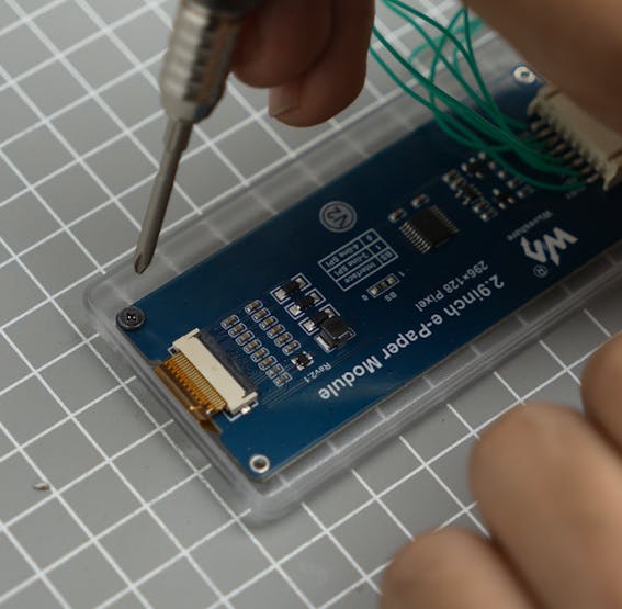

3. Install the eink module into the display frame by securing it with M2 5mm screws.
4. Secure the XIAO PCB using M3 screws.

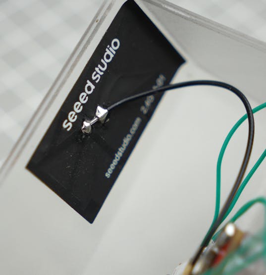

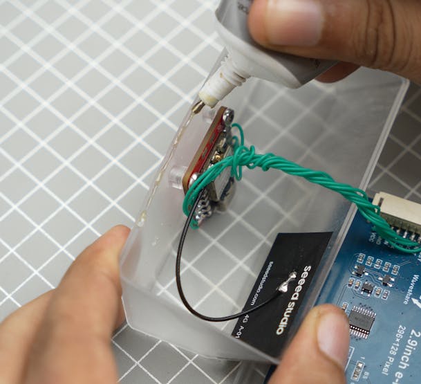

5. Install the antenna
6. Add some glue and close it off
