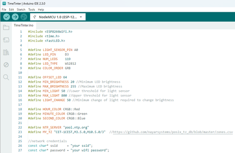

- NodeMCU ESP8266
- WS2812B RGB LED strip, 60 LED/m, 2m
- Side glow optic fiber 3mm, 5m
- Resistor 330 Ω
- Resistor 100 KΩ
- Photo resistor (GL5539, 10 Lux:50-100 KΩ)
- Electrolytic Capacitor 100uf
- Power supply 5V/2A
- 5V power cable with DC plug 5.5x2.1mm
- Steel Wire 25cm
- Filament 500g, I used PETG
- Spray paint, optional
- CA glue
- Hot glue

Step 2: Wiring Diagram

- Connect and solder everything according to the wiring diagram. Take care to ensure it all fits properly.
