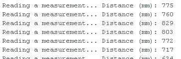

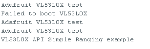

First off, plug in your Arduino R3 into your computer to test out your sensor. Select your board and upload the code to your Arduino. Then, select on the Serial Monitor button on the top right of the program screen. Since Adafruit's code on line 6 specifies the number "115200", make sure to go to the rightmost tab in the Serial Monitor and select 115200 baud. Having it on any other setting will result in errors.
The serial monitor should then be printing out lines shown in the final two images. If this test is successful and you do not notice any issues or inconsistencies with your sensor, continue on.
