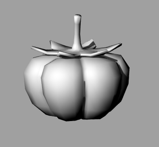

I used Rhinoceros to make a model of my product.
My model looks a bit like a tomato, but also a little like a small pumpkin—I combined the two forms.
Then I sliced it horizontally through the middle, dividing it into an upper half and a lower half.
