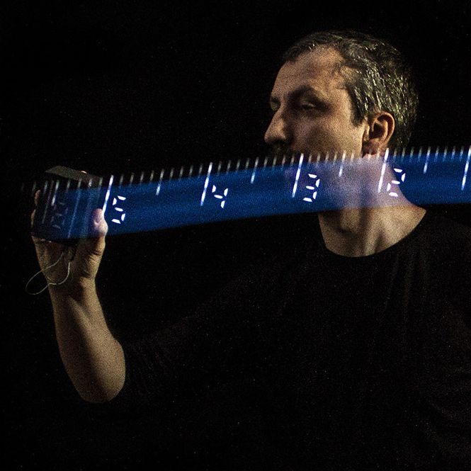

TimeRuler is a time-space measuring tool, using light-painting technique. It can be used for fun, for measuring high speed movement in different sports or as an educational device for schools.

Set your camera to a few seconds long exposure with self timer, than paint some light in a dark space. Adjust ISO and aperture until you got the desired quality. Additionally if you want the painter to be visible in the picture you can give him/her a radio trigger, which is triggering a flashlight.
Play, Measure, Enjoy
