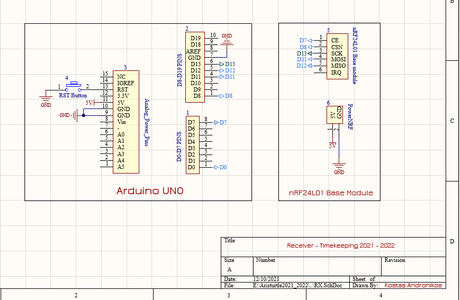

The receiver subsystem consists of :
1 x nRF24L01 base module
1 x E01-ML01DP5 V6.5
1 x Arduino UNO
Power Supply : From PC through USB
Step 3: Schematic Designs

We tested the system with the receiver on the left and the transmitter on the right. Note that this set up is suitable for keeping the time for the Skidpad Event. We also found that the maximum distance that these modules have is around 400m in line of sight (LoS) by sending 1 byte/s.
