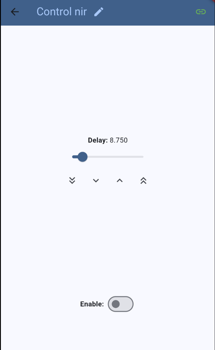

Step 4: Mobile Application
I wrote the mobile application in flutter so the application should work on Android and iOS, but I only have an Android device to test it on. It is pretty bare bones and simply searches for the device once it is powered. Then connecting to the device with BLE it allows you to set the rate it sends the signal to control the shutter.

Mobile App
Launch the mobile app on your phone and hit the search button. This will find the ESP32 remote with Bluetooth LE and list, Stop the scan and click on the device. This will present delay configuration and an on / off toggle. If you have played with this prior, the last delay value used will be loaded up.
The objective is to maximize the shutter open time. The camera takes time to write to the memory card once the shutter is closed and will not be ready for the next shot for at least part of a second. With the memory cards I use with an 8 second exposure it takes about 500ms - 700ms to write the image to the card. So to ensure a slow write doesn't miss a frame I use 8.750s between shots.
Once the timing is setup toggle enable. About 5 seconds later the camera ought to open the shutter and then after the shutter speed time close the shutter. If the camera had sufficient time to write the image to the memory card before the delay time it will open the shutter again. If there wasn't sufficient time that second shot will be missed and have to wait the delay time. Tune the delay time to ensure every shot has the shutter closed for the shortest time between shots.
