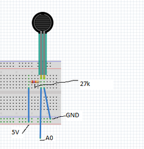

The Force Sensor circuit isn't anything too complicated. The main component in it is a 27k resistor.
The force sensor does exactly what you think it might do: Measure force. Attach it to your LinkIT ONE just like the diagram above. Note that Fritizing doesn't have a LinkIT ONE in it's database yet, so showing the 'schematic view' (which would be more accurate) wasn't possible. You of course wouldn't actually attach this all to a breadboard when actually deploying.
