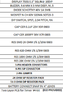

  1. Get Solder Paste and apply it to the PCB
  2. Add the IC's to the appropriate locations
  3. Reflow the surface mount IC's (In my case, I've used an oven)
  4. Add remaining parts to the PCB by using a regular hand solder and solder paste
  5. Add wires to connect the board to power and GND
