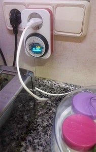

Project born from the need to correct the huge error of a cheap electromechanical timer for socket.
(Delay of about 25 minutes per programmed hour) :-P
The timing was performed by a small clock powered at 30v by a voltage divider (and of a very poor quality in terms of its inaccuracy), and the output was controlled by a switch that was mechanically operated during the rotation of the clock.
I already had a version of timer controlled with Arduino and relay output, without RTC, mounted reusing the box of an old router. In spite of not having RTC it had an acceptable precision, approximately 1.5 seconds per hour. This timing was based on the arduino timer2 and needed a support counter. Timer1 (16 bits) was discarded, which would have been more convenient, because it was a multipurpose assembly and had some servo outputs, so it was decided to "respect" Timer1, which is the one on which the servo library is based.

In this case, and due to the fact that it is going to be used exclusively as a timer, Timer1 is used which, being of 16 bits, allows more than enough to make the necessary count at once and avoids having to have a secondary counter as in the case of Timer2 (it also makes the timing adjustments much easier). This new version of the software timer based on Timer1 achieves an error of approx. 0.14 seconds advance per timed hour.
So having this electromechanical timer, useless by all means, was a golden opportunity to cannibalize it and create a timer that is minimally accurate and with a compact and unobtrusive physical appearance. (Better? of course).
Due to the limited space available, the arduino UNO of the original version is replaced by a NANO. The relay output is replaced with TRIAC and optocoupler. The 16x2 LCD is replaced by a small OLED display of 128x64 pixels, which, truth be told, allows us a greater amount of information. Of course, it is also I2C communication and we must take into account that its writing and refreshing needs a little more than 40 ms (a real eternity). We must also place inside the power supply for Arduino NANO, in this case reusing an old mobile charger.
