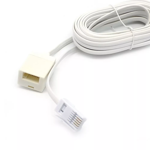

🔌 Finding a Plug for the Calliper
Getting a plug to fit the digital calliper is surprisingly difficult — they’re pretty much non-existent unless you buy an expensive bespoke lead. You’d think the Chinese manufacturers would sell the plugs separately, considering they sell just about everything else… but no luck.
So I got creative.
I found something with the right pin spacing: an old land-line phone wall socket — not the plug, but the socket itself. These old phone line extensions are cheap to buy online, and inside them is a plastic frame that holds brass pins.
I dismantled the socket and carved out a plug from that frame. The brass pins needed a bit of reshaping to slide into the calliper’s connector properly, but it worked. Hopefully the images I’ve included show what I mean.
🧪 Alternative Method
If you can’t find a suitable plug or don’t want to modify one, there’s another option: You can solder wires directly to the traces on the calliper’s PCB. Or, if you have a compatible socket and plug pair, you could solder the socket to the calliper PCB and use that instead.

🧵 Cables & Wiring Tips
  1. If you’re making your own calliper plug using a phone extension socket, you’ll already have the cable you need.
  2. For USB, use a cable with a USB-A plug to the PC, Mini-USB to the Interface.
  3. ❌ Avoid USB-C — they’re more complicated and often have extra circuitry.
  4. ✅ USB-A cables use a simple 4-wire setup, perfect for this project.
