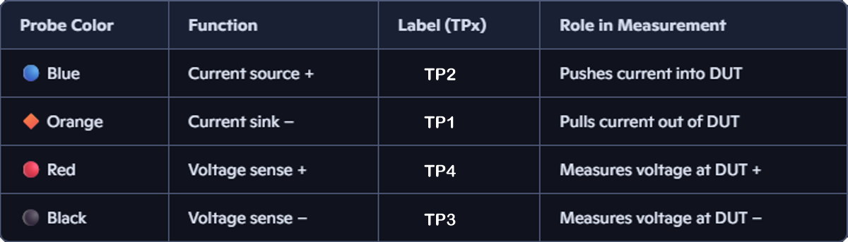

Here’s a simplified diagram from the video:
  1. 🔵 Blue and 🟠 orange wires carry current through the DUT
  2. 🔴 Red and ⚫ black wires measure voltage across the DUT
  3. The meter reads voltage → you calculate resistance using R=V/I
This is the essence of Kelvin sensing — and it’s what makes our meter accurate down to milliohms.

  5. 🧪 Probe wires connect to TP1–TP4 (current and sense paths)
Use the Fritzing diagram to match pin positions and wire colours. Make sure to keep the sense wires separate from the current path — this is critical for Kelvin accuracy.

🔌 Probe Breakdown
Here’s what each probe does:
Table
The voltage probes connect inside the current path — directly across the DUT — but carry no current. This ensures the voltage reading is pure, unaffected by wire or contact resistance.
🧪 How to Connect to a DUT
  1. Connect the blue and orange probes to either end of the DUT — this completes the current path
  2. Connect the red and black probes to the same points — ideally as close to the DUT body as possible
  3. Make sure the sense probes are inside the current path, not outside the clips or leads

🟨 Probe Connector
The only part that differs from the breadboard version is the Kelvin probe socket. The PCB uses a proper 4‑pin connector footprint, giving you:
  1. A secure mechanical connection
  2. Correct spacing for Kelvin clips
  3. Clear silkscreen labels for TP1–TP4
  4. Reduced wiring clutter
If you prefer, you can still solder wires directly to the pads.
