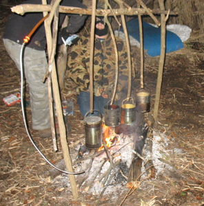

*Update* The outpost took thier kits out of a little survival camp a few weeks back. I thought I would put this up as a little proof that yes, they do work just fine. Every can stood up to several meals and more importantly each boy was able to cook and carry his own.
