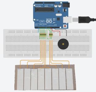

Step 4: Assemble the Circuit
Assemble the circuit as shown in the image above.
