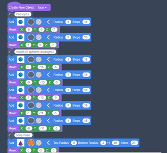

  1. Ask the students to pick a snowman accessory (examples: a hat, carrot nose, buttons, smile, stick arms, mittens, scarf)
  2. Work to build that ONE accessory using codeblocks.
  3. Break down the shapes (example: A top hat is two cylinders, one wider and shorter than the other. A stocking cap is a half sphere with a torus around it and a sphere pompom on top)
  4. Build up the solution piece by piece. (Place, test, move, test)
  5. Each new object should be it's own stack of blocks, topped by a "create object" block- this helps stay organized
  6. Once you have finished an accessory, pick another and repeat (until you run out of time)
Hints:
  • Putting new objects BEFORE old objects makes it possible to see those new objects- everything is built at the origin and then can be moved later.
  • The Modify-->Create Group block is helpful- after building a complete object at the origin, group it and then move it all together.
  • Use COMMENTS to note what is happening in parts of your code so that you can find parts when adjusting or troubleshooting later.
  • Really emphasize how movement works (If they are viewing from the front plane: X movements are side to side, Y movements are forward and backward, Z movements are up and down.). If a kid is stuck here- have them just move something around for awhile and watch where it goes with different values.
I have attached 4 screenshots of example code to this step (arms, hat, face, and scarf). All of these have been made for one snowman so some values would need to be tinkered with if you decide to copy this code. Also note- my students have figured out 50 different ways to make these items and more, when left to their own creativity and given the time and freedom to play with the code.
