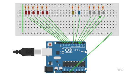

A clock made on TinkerCad(also building it in real life but no time to finish it for the clock contest due 2/27/23). Red represents minutes while white represents hours. The yellow represents AM and blue for PM. The LED off represents 0 while the LED on represents 1. Hours go up to 12 while minutes go to 59, both represented by binary.

Step 3: Build the Circuit
Build the circuit on TinkerCad according to the picture.
