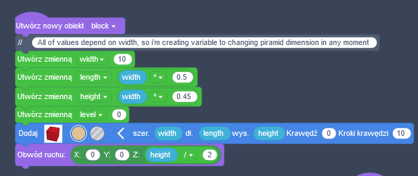

Step 1: Creating the Primary Block
In this step i created a block with its dimensions used all the time. Also i moved it by half its height to relocate it above the surface(axis z= 0). Except a block i created basic variables too.
Use of variables allows to change block size and pyramid size by only changing the width value. The ratio(1:2) of sides(collected from Lego 4x2 block :D) helped me to construct this pyramid by use of 4 blocks and turn formula.

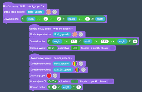

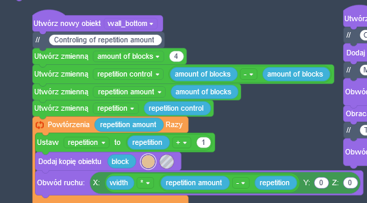

Step 2: Walls
With next organisational unit i added new variables witch allow to control a block placement and its amount.
Primary form of this project is block and its the most important dimension: width, so distance of block placement is mean in width.
"The Universe is wide"
- Me the scream
With each new wall the form of wall script was changing, so I'm placing here all changed wall script formula^.

Second wall

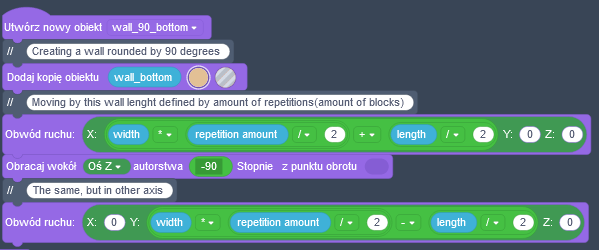

After creating walls they should be copied and rotated by 90° - construction of wall_90 up^
//wall_90 - I mean wall rotated by 90 degrees

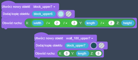

In many cases here I didn't use exactly the same form of code for each 90 wall.
It depends on a level:
  1. In uneven number of level, there are 4(at first level) blocks and block rotated by 90° in line.
  2. In even numbers block rotated by 90° is behind 4th(depends on level) block.
In the next to last level there are only block and identical, but rotated(90°) and(of course corner). - up^

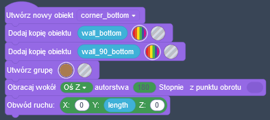

Corner
Corner is a wall and wall_90 collected in group(new colour) and rotated by 90°.
At the final level there is only block and parallel to it its copy. - up^
I must to say that corner was the easiest part of coding, but - at the beginning - that didn't was short like now - remember compression in coding is very important. For curious people it was exactly the like wall and wall_90 script gum together.

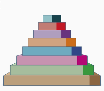

Step 4: Naturalistic
The last step is about a cut. It's cuboid rotated 60° and made invisible(I mean cut).
This cut is for making my project naturalistic, because Pyramids construction block had a cover blocks from white polished limestone(first step - History). I don't want in order that my pyramid be white, so i cut it, but colours are for educational feature and perfectly shows construction.
