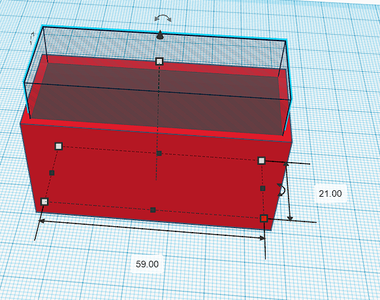

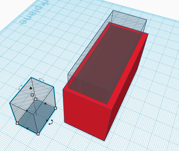

Step 2: Main Body - the Housing

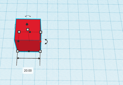

To begin

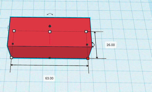

- A cube was dragged and dropped into the main window
- By clicking on the corner of the box (a little dot), the dimension boxes can be changed to required
- This model (red box) was an extra 2mm at the front and sides and 3mm on the back to allow for wall thickness

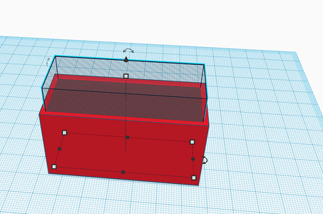

- Once the main box is right, a shaded cube was dragged in (this is a subtract, or will remove material)
- The void cube was turned into the same dimensions as a go pro 3 with an extra mm to allow for shrinking of plastic (this is where the first prototype assisted)
- To find tune or move the block around, if it's frustrating with the mouse, you can use the arrow keys and it will shift around (depending on what snap to grid setting you have)

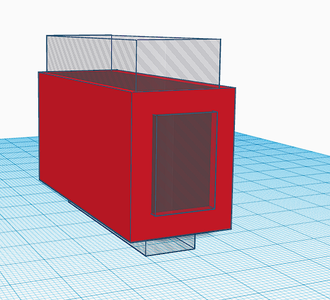

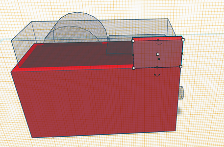

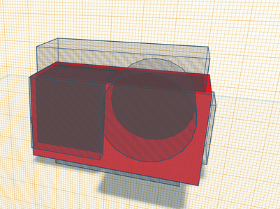

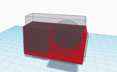

Step 3: Main Body - the 'Windows'
Following the creation of the main body, this step requires all voids
- A cylinder is added for the Wi-Fi button.
- For the cylinder's to be in the right orientation, there are curved arrows. Click on one of those and move your mouse. This will allow for the rotation of the object.
- For this project, all rotations are at 90 degrees, so no approximation is required
- You will require
- 2 cylinders, (Wi-Fi and lens)
- 3 cubes (underneath to push up, front display panel, access to SD card)
- Move the shapes into position, using the arrow keys if you are struggling with the mouse

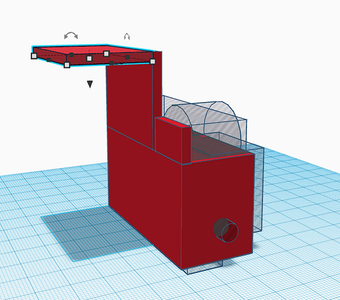

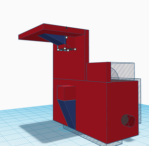

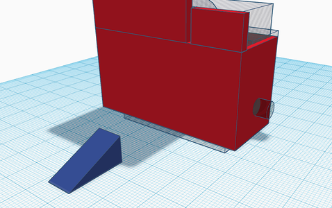

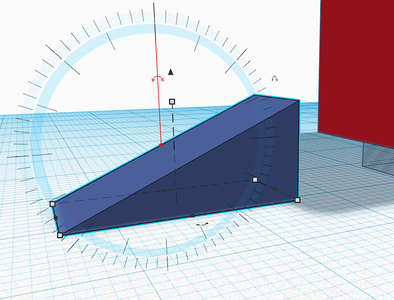

Step 4: Servo Mounting Point
For the servo mounting, there are 7 shapes required
- Two triangular prisms (dark blue), mainly for aesthetics and to add strength without adding too much weight.
- 2 flat cubes for the back, going up vertically. These were 3mm thick and a small space between them to allow for the servo arm to reach between. That space needs to be in line with the GoPro's top button
- 1 flat cube which will have the connection to the mounting point. This is 3mm thick and lays horizontally off of the vertical cube.
- 2 small cubes (roughly 10mm x 9mm x 9mm) for where the servo will screw onto
*To move pieces higher up, use the workplane tool (see image). This means the shapes you create can be placed on the new plane as well as use the arrow keys to move in different directions

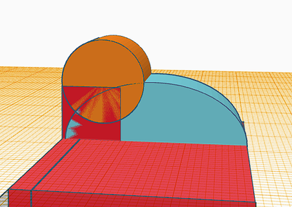

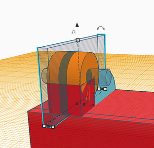

Step 5: Connection to Go Pro Mount
The mounting bracket might be seen as a little bit intimidating but
- 1 semicircle (light blue) which is wide enough for both mounting 'fins' (7 or 8mm)
- 1 cube and circle which are where the bolt of the GoPro mount passes through
- 2 voids
- A cylinder for the location of the GoPro mount bolt
- A cube (long and 3mm wide) placed in the middle of the semicircle to create the 2 'fin' like structures
