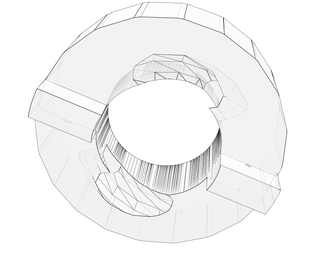

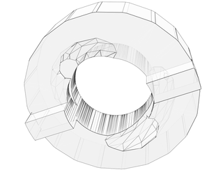

Step 2: Assembly: Ratchet Mechanism

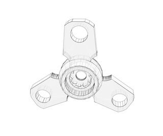

After you have sanded down the parts and have made sure that all the central parts are able to move freely and the ratchet hooks and teeth fit snugly you will be able to assemble your spinner!
Make sure the teeth of the inner mechanism are able to bend inwards with little ease.Sometimes the teeth of the inner mechanism can fuse, preventing them from moving. These fused ends will have to be separated.
Insert the ratchet mechanism into the center of the 3 armed shell, making sure that the flat side of the 2 hooks make contact with the flat side of the inner teeth of the shell. When you rotate the inner ratchet clockwise you should notice it to start to apply pressure onto the shell forcing it to rotate. Rotating the mechanism anticlockwise should relieve pressure allowing the shell to move freely.

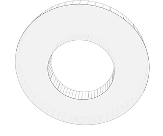

Step 3: Assembly: Seal
I found this adaptation to be unnecessary as it provides excess friction which slows the spin. However if you have enough time and you want to include it in yours you can...
Insert the O-ring from the front side of the shell into where the ratchet is located. This is to prevent the ratchet from popping out.

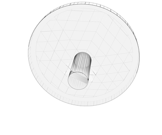

Step 5: Assembly: Button and Ratchet End-Caps
Insert the button's axle into the separate ratchet end-cap, making sure that the nobs on the cap face away from the button grip. Then insert the pin into the hole at the end of the button's axle and secure it in place with super glue. Make sure that the rod ends extrude evenly on either side of the axle. Repeat this process with the other button, ratchet end-cap and pin. Note: The end cap should be able to rotate freely from the button. Also, remember which button contains the front cap, and which the back cap.

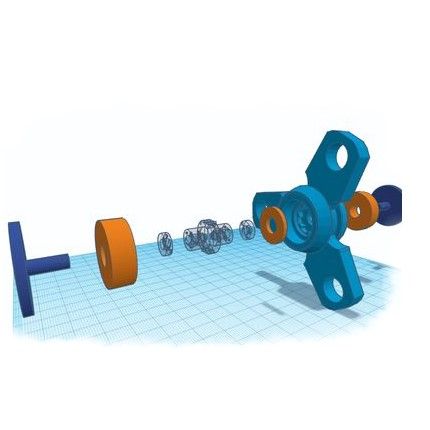

For the front cap and thus front button: Glue a spring to the end of the button axle and wedge a piece of a cork between the button grip and the end cap. Then apply a small amount of glue onto the side of the cap where the nobs are, and fix it to the mechanism within the spinner shell. You should find the cork allows you to apply pressure to the cap and mechanism when affixing them together.
Wait for the glue to set and repeat the process on the opposite side.
*The small objects between each arrow in the diagram are the springs.

Step 11: Exploded View
