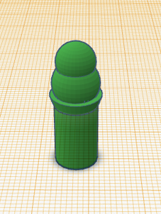

Step 1: Create the Pencil Topper Base

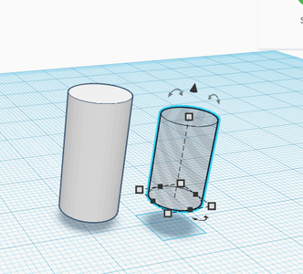

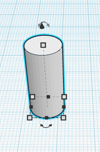

Drag a cylinder onto the workplane. Make the cylinder 9-10 mm in diameter.

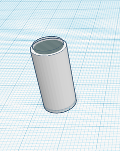

Drag another cylinder onto the workplane and make it a hole. Make the hole diameter 8mm.
Select both items, align them and group them to make the hole in cylinder 1.

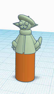

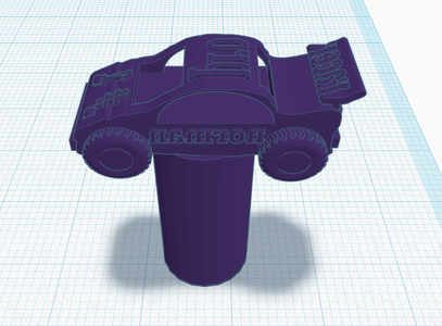

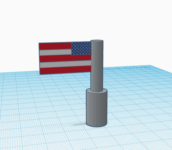

Step 2: Add Base to Shape

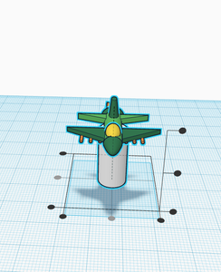

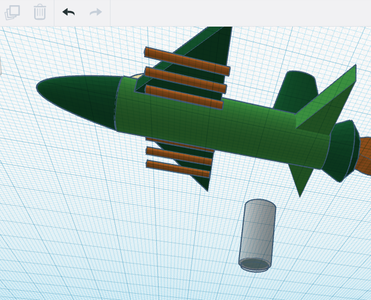

Copy and paste the pencil topper base into a project that you have created or use the shapes provided in Tinkercad. I used a jet that was a prior assignment.

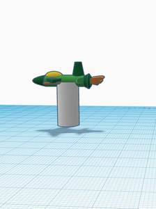

Step 3: Fit, Align and Print
Shrink the shape (jet) to fit the pencil topper base. Select all the shapes and use the alignment tool to align them. Export the .stl file and 3D print!
