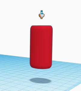

Step 3: Build a Punching Bag
This utilizes the new Pivot Connector. Once built, test it in the sim lab. Note you can make copies of it so there are many punching bags to play with. Using the chapters in the video will make this easy peasy.
