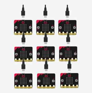

Log in to your Tinkercad account and click on the circuit button at the left of your screen. At the left of your screen search for Microbit under the Basic category.
Drag 6 Mircobits onto the workspace and arrange it as shown in the picture above.
For easier reference, we will call the Micro: bit at top left as Micro: bit 1 and micro:bit at its right as "Micro: bit 2" and so on

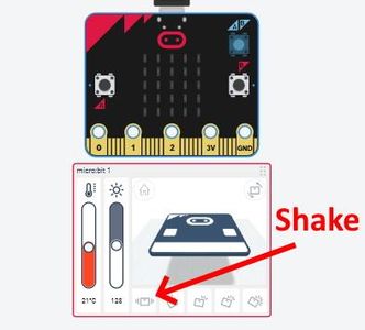

  • We also want this Micro:bit to send a message to all the other Micro:bits to Clear their respective screen whenever we shake this Micro:Bit. To do this we will bring out an "on shake" block and then insert a "radio send number 1" block from the Output, inside the "on shake" block.
  • Finally, look for the "clear screen" block under the "radio send number 1"

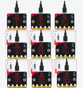

We will program rest of the Micro:Bit in a similar manner as we have done in the previous step. There is 2 major differences that we have to make sure of. These are:
  • While programing the "show led" block for the "on start", Make sure that each Micro:Bit is displaying the letter of the word TIC, TAC, TOE. Please refer the image above.
  • To program the Micro:Bit to delete the content on the screen when "Micro:Bit 1" is shaken, we need to use "on radio received number" instead of "on shake" block. You can find this block under Inputs. Now, inside this "on radio received number" block we place an If-then statement block to clear the screen when it receives the radio signal from "Micro:bit 1".
Step 4: How to Play
Our Game is ready to play. Click on the "Start Simulation". Now share the mouse with your partner to choose between 0 or X, clicking the button A or B. You can clear the screen and start afresh by clicking on "Micro:bit 1"
